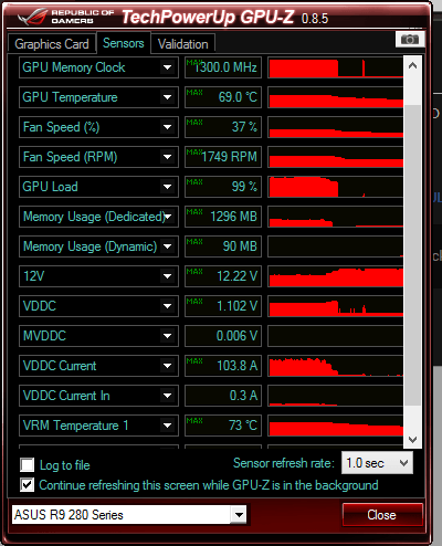

15 mins of valley
https://linustechtips.com/topic/471053-question-about-vrms/#findComment-6316372
I don't think there is anything particularly wrong with the card, those temps can be accounted for by component variance and the voltages look fine. I'd assume here that on the card you have the vrms don't make contact with the heatsink and are only cooled by passing air. You can try blowing out any dust from the heatsink to make sure you're getting good airflow past the vrms, but I wouldn't worry about it too much unless the max temps you see are rising over time as that would indicate a slowly failing component.

I actually have reverse airflow thanks to the CPU cooler, maybe that has something to do with it? On an open case I get 64*C. As for voltage, I don't think GPU-Z is particularly reliable as sometimes it reads spikes to 1.442V which should have fried my card several months ago if it were the case, right?
