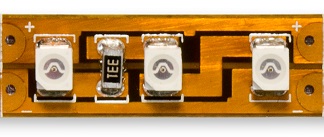

I'll use an SMD3258 LED strip as an example since it only has a positive and negative and can't do RGB. What happens is the 3 LEDs are wired in series with a resistor to achieve the 12V rating and each 3 LED section gets hooked up in parallel to the next section so it allows for cut lines of every 3 LEDs, mind it has to be done on the specified cut lines. For RGB it's the same concept but instead of just positive and negative they have to power for Red, Green, and Blue in the LED and a common ground wire (4 Wires).
As for using it under one controller once you cut it say in half, you will need to install new connections to the cut LED strip by soldering on some power leads so it's won't go to waste, and controlling one LED strip is no different than two LED strips you can connect the two strips either in parallel or series and they both will have the same color and controls, the only thing is there is a max limit for series length which i think was around 10M or two 16.4ft rolls.
SMD3258:
example-of-3528-smd-chips.jpg?t=14016847
SMD3258:
Makes sense, thanks for clearing that up.
