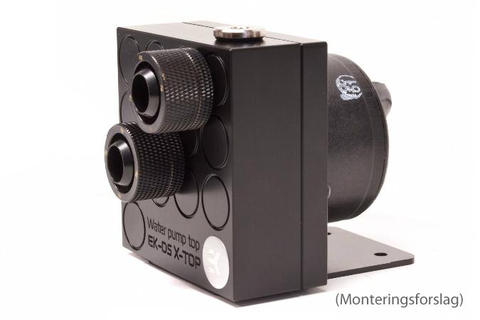

Yes as long as you buy a D5 with a threaded pump top such as this one
You need the threaded top so that you can screw in those fittings.
