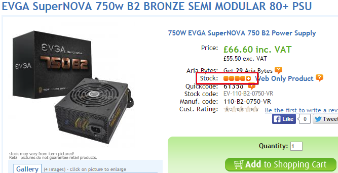

It's not on that site. http://www.aria.co.uk/Products?search=EVGA+750W+&x=0&y=0&searchCat=619
And I have never used that site. I'm more comfortable with using Amazon for my purchases - unless someone can convince me the customer service elsewhere is good. Discussion: http://linustechtips.com/main/topic/239573-purchasing-pc-components-what-are-these-retailers-like/
http://www.aria.co.uk/Products/Components/Power+Supplies/Modular+700-950W/EVGA+SuperNOVA+750w+B2+BRONZE+SEMI+MODULAR+80%2B+PSU+?productId=61358
I haven't heard any issues with any of the merchants listed on pcpartpicker other for things like mail-in rebate.
If you must use Amazon, go ahead and get the 850G2.
