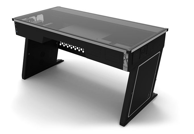

I would just buy the desk case from Lian-Li before trying that. All sorts of problems could happen.

Just buy one ^^^
Will be way better and work 100%
https://linustechtips.com/topic/183172-pc-in-table/#findComment-2462171
but that's boring and costs a lot of money
But looks better, is higher quality, and is guaranteed to work on the first try.
Unless he has metal and woodworking tools already, it will be cheaper to buy a pre made desk.
