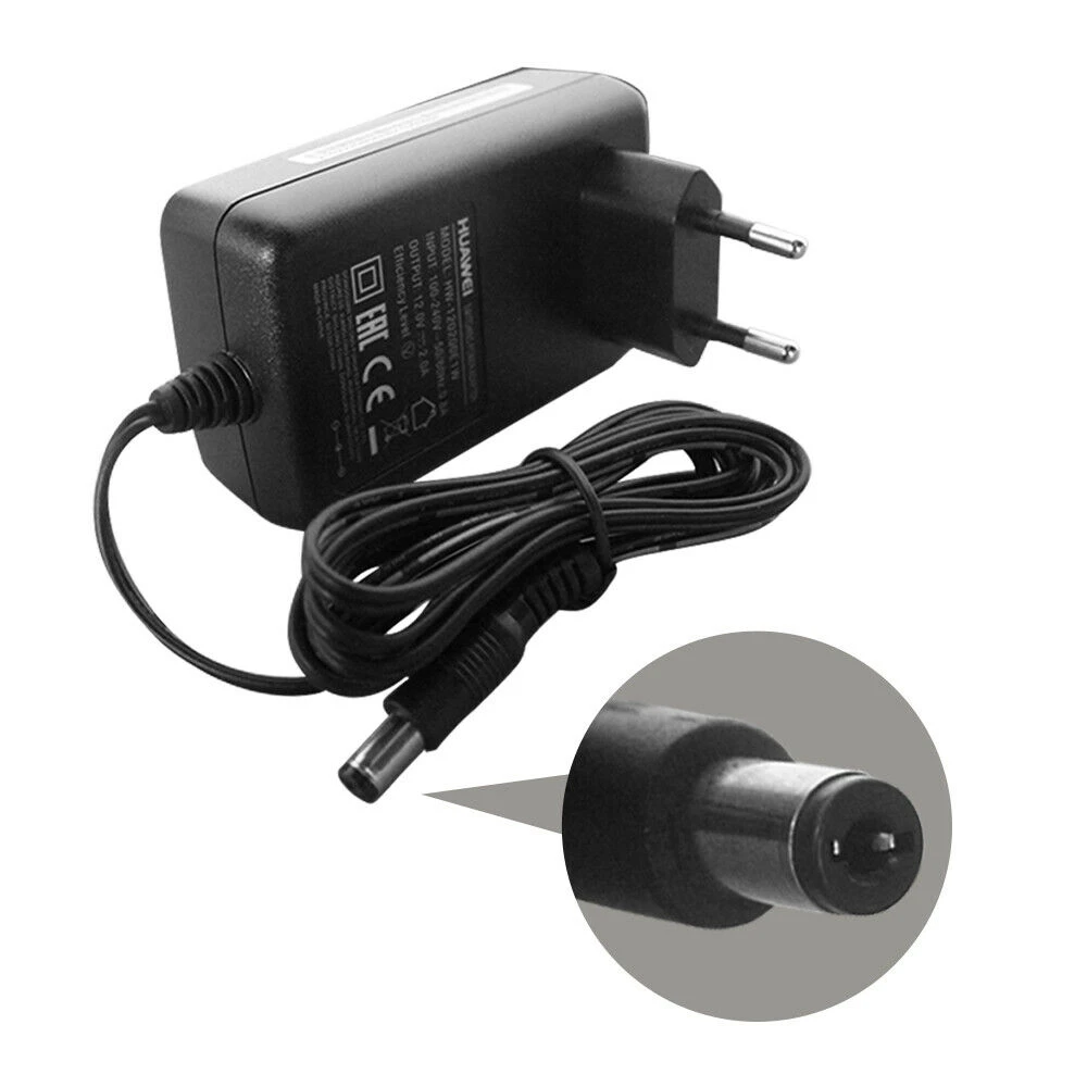

Good evening, I have the TP-Link W8961N V3 modem-router and it's ac adapter says 12V 1A and I want to ask if I use an ac adapter from another modem-router (Huawei DG8245v) which is 12v 1.5A will it work properly or it will catch fire ?? And if it does work then can I do the opposite, use the tp-link ac adapter on huawei modem-router ?? Thanks in advance !!

Why change adapters if you have the correct one? However, don't do the opposite. If the polarity is the same, then yes. As long as the adapter puts out the same or is capable of putting out more current it should be fine to use on that device. It should put out the amount of voltage listed, but it will only output the amount of current needed. So more powerful is generally ok. Not enough current is not ok. That is why trying to use your 1 amp adapter on a device that could draw 1.5 amps is not ok.
I want to use the huawei adapter on the tp-link router because of its shape, it does fit more nicely on the power strip. The tp-link adapter its like THIS and the huawei like THIS. Both are 12v and the connectors on both are physically the same. My concern is if there is a problem if the ac adapter have more ampere "0.5 in this case" than the router is rated for.
