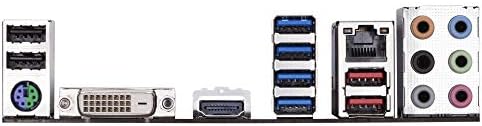

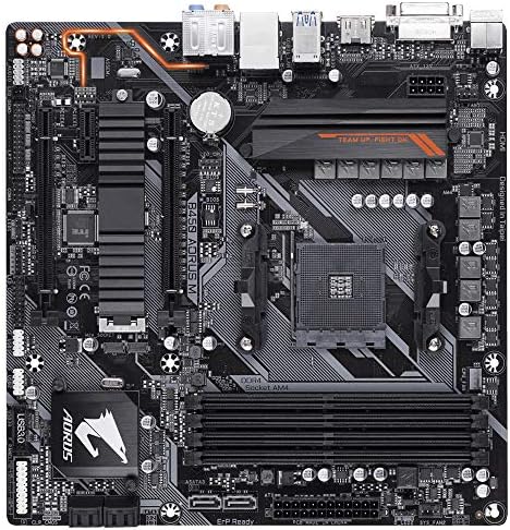

Ok at the end of the line here I have a Ryzen 3 2300x processor and have tackled it in 3 different motherboards with all the same result no display or post so after looking I see my boards are not compatible with this chip so what I'm asking is does anyone actually know what board this chip will work in I'm looking at this
Aorus B450 AORUS M (Socket AM4/B450/DDR4/S-ATA 600/Micro ATX)
  1. Aorus B450 AORUS M (Socket AM4/B450/DDR4/S-ATA 600/Micro ATX)

Thank you i will have a look I have already tried Asus prime A320m-K and same board -R again I will have a look just this board was easily available for me

1 minute ago, Andyg666 said:
Hey buddy no I have just been using the onboard hdmi I'm waiting on my new GPU was just setting it all up
The CPU doesn't have a built-in GPU, so you are not going to get video out of the mobo.

4 minutes ago, Andyg666 said:
Great I will get a card fitted tomorrow and see what happens fingers crossed but just incase would a B450 be compatible even if I need separate GPU thanks for the info .
Yah, a B450 should work with the CPU just fine.
That HDMI port doesn't work with your CPU,you need to connect your display to a GPU.
The board you have now is probably working,you just need a GPU to display a picture...

What motherboard are you using?
Edit:
I'm assuming it's the Gigabyte B450 Aorus M you linked in the first post. Do any of the debug LEDs light up? Number 22 in this picture.

6 minutes ago, Andyg666 said:
Ok it's a gigabyte ab350 gaming board.
Plugged into GPU.
Lights up led on motherboard and GPU lights up and fans spin when booted
500w Psu
Make sure you quote or we don't get notifications that you replied. I happened to have this thread open still.
It seems like revision 1 of that motherboard didn't have debug LEDs, but some of the newer ones have them in the bottom right corner near the front panel connectors and bottom Sata connector. Does yours?
