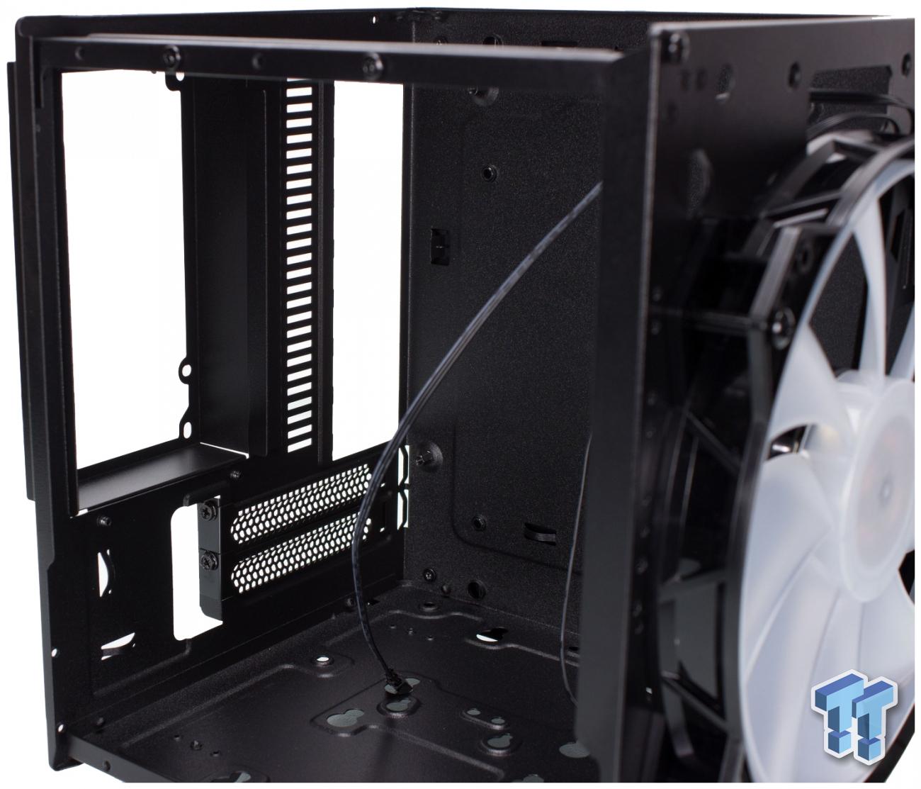

So iv been looking for a mini itx case and so far the coolermaster h100 seems like the way to go however iv got a few worries about the airflow as I’ll be putting a Ryzen 7 3700x in it with a gtx 1660ti. Is there any better mini itx cases I should take a look at.
Iv for a budget for under 200 usd including case fans to go along with it

On 7/9/2021 at 9:34 PM, wavem2 said:
Thing has an full mesh front panel, what more could you possibly ask for in terms of airflow? Just a massive hole?
This is EXACTLY why people need to do more research into a case without just looking at a front panel and making an entire decision about how good the case is.
"But wait, it's got a mesh front panel and a huge 200mm fan. Your 380T has the same thing! So what's the problem?"
The Internal Layout Doesnt Leverage The Airflow Provided
If you watch or read any review on this case (that actually BUILD in the case), you'll see complaint after complaint about how terribly thought out this case is. The PSU is a normal FULL SIZE ATX which sits directly over the CPU cooler location. So you can ONLY use a low profile cooler (and fight the PSU fan) or an AIO (which defeats the purpose of the front fan as there's nowhere else to mount a fan.)
In addition, the GPU is almost literally choked. Some users will say "Dont get the H510 it has no airflow and chokes systems" no the H510 has airflow. This case has zero ventilation points for a GPU; it basically puts the face of the card straight down into the bottom of the case with no holes or ways to get in any sort of air. The 200mm fan doesnt go low enough to even push air into the front of the card. You may as well put your GPU in it's own box!
Cooler Master MasterCase H100 Mini-ITX Chassis Review | TweakTown
Coolermaster's photo's manipulate the image to make it look bigger and more spacious than it really is (also placing the ATX PSU fan against a completely solid side panel)
MasterCase H100 | Cooler Master
When in reality:
(And that's an SFX PSU they used because Dmitri knew ATX would be suicide)
