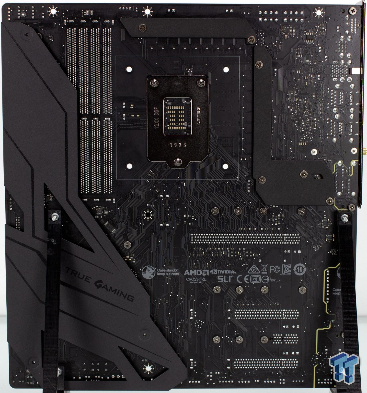

Check the back of the board and see if the PCIe x16 slot (assume it has one) has solder points through out the whole slot. Some prebuilts have it wired to only 4x (in that case solder points will be much shorter than the slot itself), limiting power draw to 25w and also your card options.
I think @Jurrunio is referring to the computer’s motherboard rather than the board on a potential card if there is any confusion.
yes it does have a pcie x16 slot, thanks
https://linustechtips.com/topic/1258012-cpu-or-gpu-upgrade/#findComment-14119642
Sure it has a 16x slot, but what I think was being asked is are all the 16Xes actually powered?  Presence of the connector apparently does not equate necessarily to actual connections.  This is much more common in slots other than the #1 slot on whitebox boards but this is an acer(?) board which implies it is not whitebox. The issue seems to be not the bandwidth but if the connector will actually provide enough power to run the card.

1 hour ago, Le monke said:
Yes it is powered, when I got it it the previous owner some old ati card in it it gave an output but crashed to desktop whenever I tried to run games, so I took it out.
so all looks like the top and not the second and third ones (if not shorter)?
9514_24_msi-meg-z490-godlike-motherboard
This is a board with x16 x8 x1 x8 wired PCIe slots even tho the slots themselves (seen on the other side) are x16 x16 x1 x16.
Yes, exactly.
