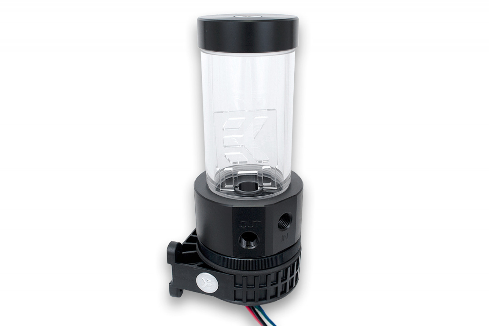

I don't know which pump/reservoir you are using, but mine is one of the combo ones from EKwb:
EK-XRES 140 Revo D5 PWM (incl. pump)
