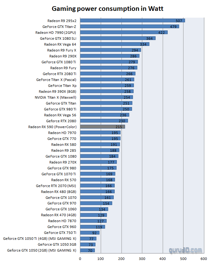

Well, about the only problem I see with this list is the GPU.
RX590's real world power consumption is well over 200W, according to Guru3D, and I don't think it'd a bright idea to shove that hot mess into a mini-ITX:
If I was you, I'd look into ~120W GPUs. GTX 1660Ti comes to mind.
Undervolting, paired with underclocking is another valid option.

You should go with the RX570 then. It isn't that much behind the RX 590:
The RX590 has some SERIOUS overheating issues, even while inside a full tower casing with more than adequate airflow. Shoving that GPU inside a tiny little ITX would be a HUGE mistake, and I feel confident to say that you'll likely end-up regretting your decision.
Here, a person's RX590 is overheating, despite running inside a full tower casing (Corsair 460X) with no less than SIX fans (3 intake, 3 exhaust @ 120mm):
https://forums.tomshardware.com/threads/xfx-radeon-rx-590-fatboy-overheating.3494930/
You get what you pay for, laddie.
