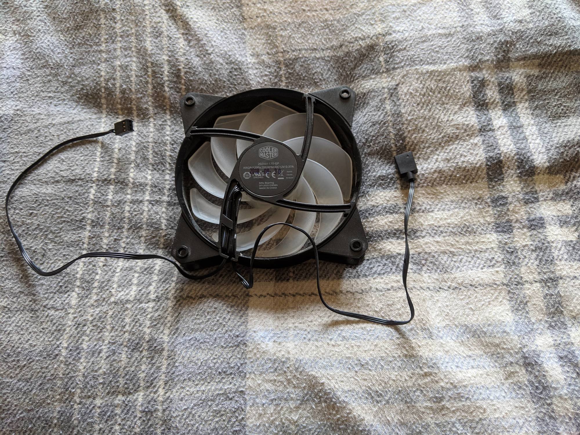

It just so happens I have an RGB fan lying around...
See how it has 2 wires and 2 connectors on it. The left hand side one is a 4 pin PWM connector for fan power, the right hand side one is the RGB connector.
You're correct in that RGB does carry 12v but it does not power the fan, the fan has its own separate power. FTR aRGB actually uses 5v and not 12v.
You can run the fan with no RGB and you can run the RGB with no fan. I currently have 6 RGB fans in my case and another 3 aRGB ones lying around doing nothing (because my current board doesn't support aRGB).

They do.
