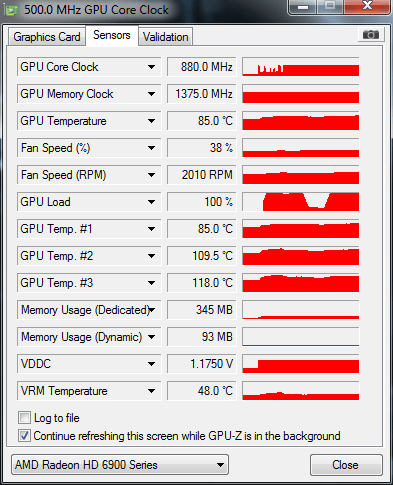

good day guys,, i have a sapphire hd6950 2gb refference card(now running as a 6970), I've noticed that it's now overheating, i cannot play crysis 3 ar battlefield 3 now because the games keeps on crashing, I've tried running kumbustor and it's also crashing, i"m not having BSOD though, ran gpu-z and noticed that there's a huge difference between the temperatures on gpu 1,2 and 3. I've tried to change the grease on the gpu chip, and i have the same result
I don't know what to do know. please help, need your experts ideas guy.... please.....

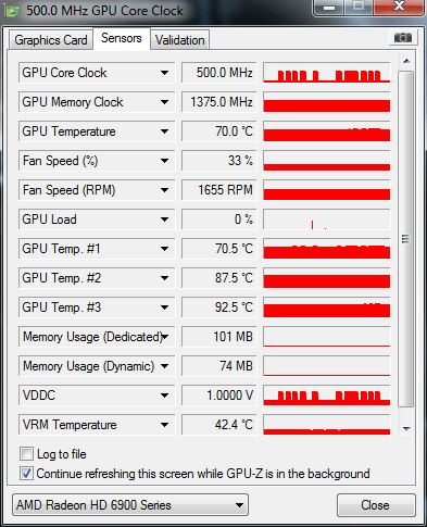

sorry guys can't upload the gpu-z but @ idle
gpu#1 is @ 69 degrees
gpu#2 is @ 99.5 degrees
gpu#3 is @ 101 degrees,
vrm temp is 42.2 degrees
and everytime the gpu 3 reaches 145 to 150 degrees everything will crash.

here's a link to my gpu-z reading at idle. i hope it works. because i cant upload any picture
[url=http://gpuz.techpowerup.com/13/04/21/2by.png]http://gpuz.techpowerup.com/13/04/21/2by.png[/url=http://gpuz.techpowerup.com/13/04/21/2by.png]

Change the fan profile settings. 85°C and fan speed at 38% ..that's too low
This, it's waaaaaaay off. Run it with standard settings (you bought a 6950 not a 6970, dead with it), judging from your postings in this thread it doesn't sound to me like you're too comfortable in the world of overclocking (or say "not so standard configs"), so for you it's better to just not touch it at all. If you are not 100% comfortable with applying TIM, check a guide or two out and see if you did it correctly. As for the whole stock versus aftermarket cooler discussion there is some truth to this but in no shape or form as much as some users claim. The stock cooler is perfectly adequate for cooling the GPU, although often noisier and warmer than aftermarket coolers, but never the less perfectly adequate.
hi hans.... I am running it on stock settings, I dont Overclock it. i know the image i showed was running on 6970 but it was done by changing on the bios, and i dont know if i should consider it overclocking it, i dont even know how to overclock it, it's purely on it's stock setting even if i run it on the 6950 bios the temps are bit lower maybe about 5 to 10 degrees lower.

hi.. I already replaced the thermal paste but not with mx-4, I used thermaltake tg-2, I replaced it several times try with different amounts, from thin to covered the whole chip up to a blob of thermal paste, I'm now trying to play crysis 3 with the fan @ 48 percent, it's a bit loud but the gpu temp is @ 90 deg. i might try pushing it a bit more
