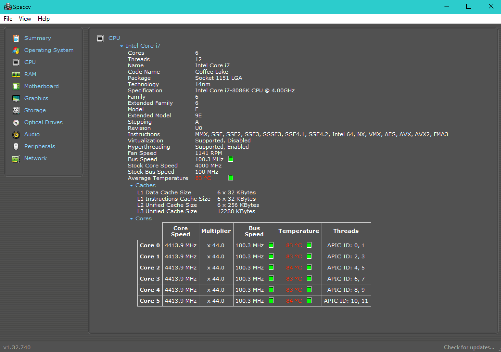

So bascily i got a i7 8086k and its getting extremley hot im using a full water cooling loop that has a 420mm ek rad ive reapplied the thermal paste ive checked the water block to see if its on properly . Im not overclocking it in anyway except the default turbo boost and on idle its hitting over 80 sometimes and underload its throttling like mad.

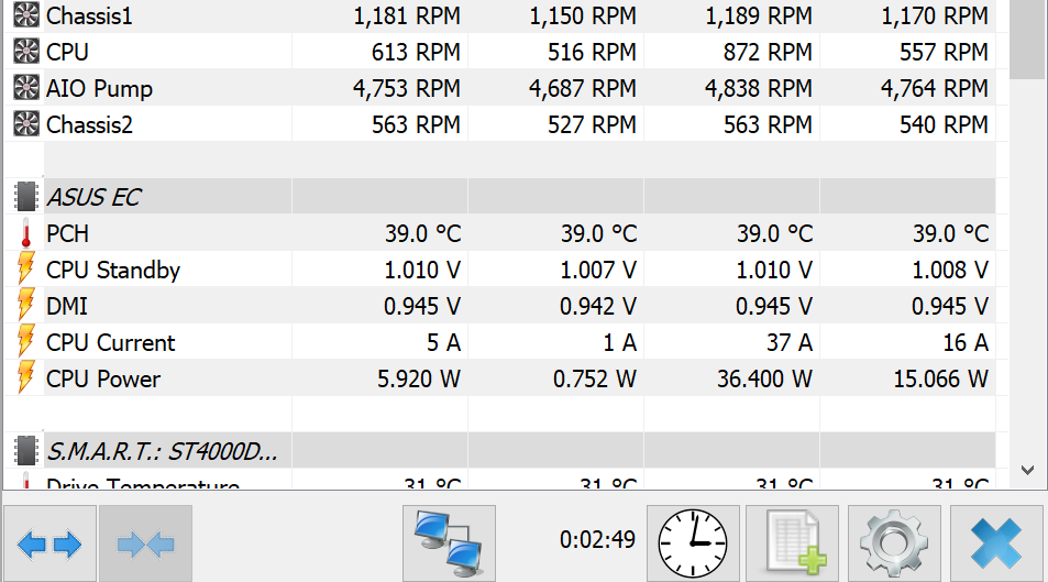

What is your pump rpm? I assume since you've managed to fill your system the pump was working (and still should be). Idling in the 80s indicate to me that there is no flow in the system.
Also can you confirm the molex power for the D5 is connected into your current PSU.
One fan missing on the radiator? no biggie, but just wanted to confirm that this is what I'm seeing
Just now, Dilwyn said:
Yeah the third fan lost a fin so it has to be without for a lil while but im not sure how to check the rpm of the pump tbh.
If you could show me or confirm the following things this would help:
- I can see that the fan header from the D5 pump is connected into the AIO_PUMP header. is this true?
- If so, either in the BIOS or something like HWinfo64 or Asus Suite, can you read the rpm value of the AIO_PUMP header
- Confirm that the D5 pump is plugged into molex power from your PSU.
- Any sensation of fluid flow in the tubes, or the sound of the pump whirring, vibrations in the D5 housing.
5 minutes ago, Dilwyn said:

3 minutes ago, Dilwyn said:
I can confirm the pump is running .

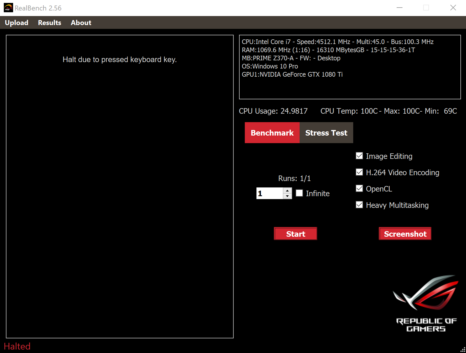

Can you clear the CMOS and try RealBench?
Its strange how warm it is even in the bios.
If you have a photo of what the thermal paste looked like when you unmounted, this can help too. Otherwise please confirm you really can't tie down the cooler any tight3er. This is my 8700K for reference.
2 minutes ago, Dilwyn said:
I just ran realbench again and it took slightly longer to get to temperature but it still went to 100
Assuming there is no air in the radtator, I am starting to run out of ideas. You can rotate the CPU waterblock to the canonical position, although I don't think this is the reason.
