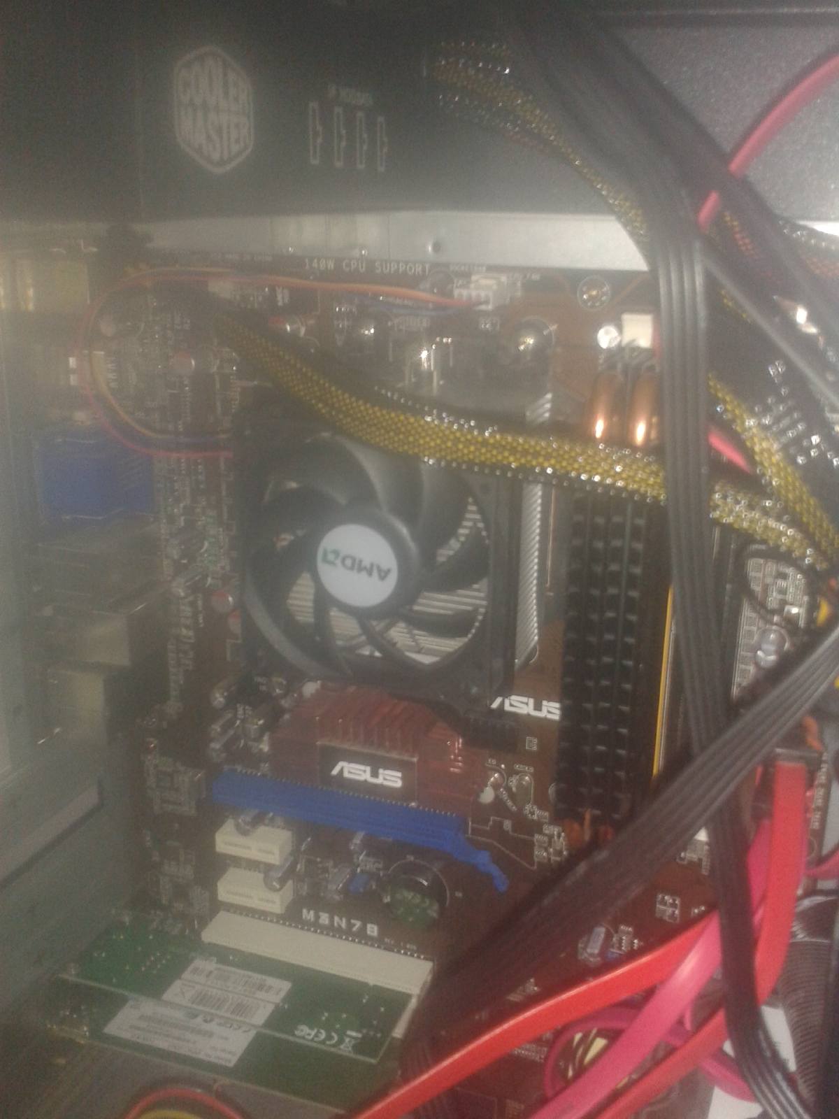

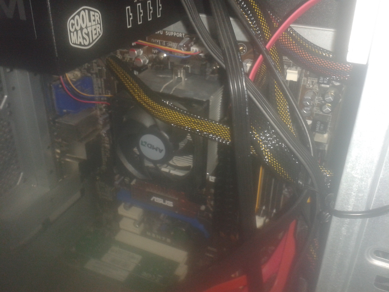

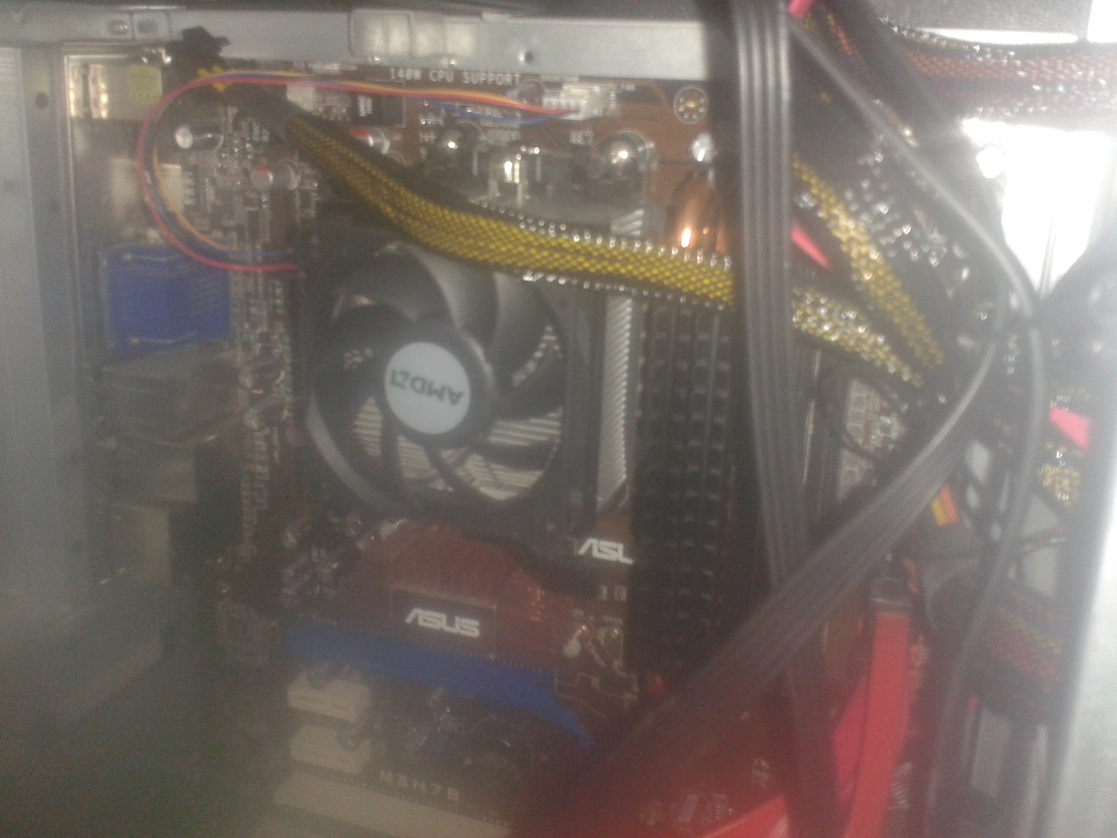

can you send us a photo of your cooler/cpu fan?
20180818_212434.thumb.jpg.4de6b04f4e374b5c0bba66db1740bf85.jpg20180818_212440.thumb.jpg.bf0c9a6381da15a03a4028bd374f4e4c.jpg20180818_212445.thumb.jpg.ff757615d7a59de0d8bce20adb9b1470.jpg
My case is not so big (mid case). And the ram modules are about only 10mm far from the edge of the fan.
