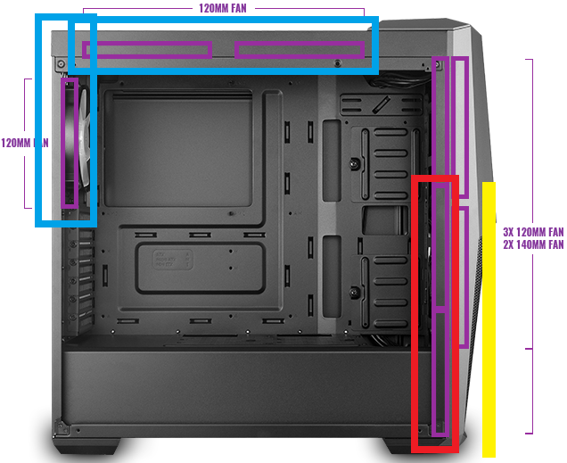

For some reason, my text disappeared.
I was saying,
In Blue are the 3 included RGB fans
In Red is the radiator
Is it possible to choose in which side the radiator fans stay? I want them in the yellow side so i can see them from the front (like in the other image without the squares).
