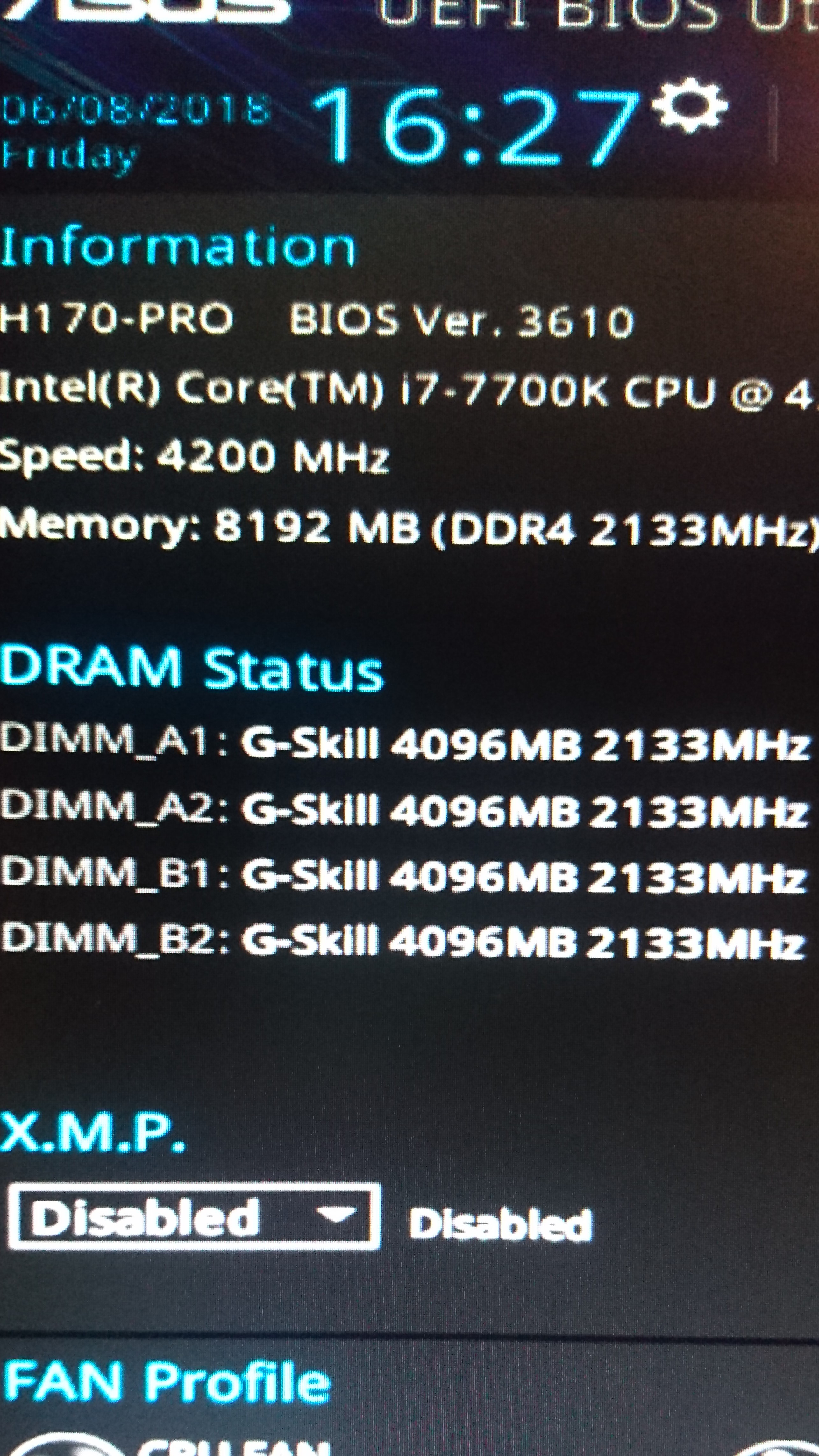

hey, so I have been using my PC with 2 newly installed RAM sticks for a few weeks now, after which i noticed a slight increase in my ram usage within task manager and i saw only 8'GB of my 16 is actually showing up within task manger, upon looking in my BIOS for my motherboard it says my total installed ram is 8 but it says all four of my ram slots are filled with 4GB sticks, I was wondering what is going on here and I've tried everything i can think of to fix it, I have tried reseating the RAM, updating the BIOS and making sure there is no boot memory limit applied.
If you need it the specs are:
intel i7 7700K CPU
4x G.Skill Ripjaws V DDR4 2133MHz RAM
ASUS H170-Pro Motherboard
Windows 10 OS
images attached are the screenshots of how my memory appears within task manager and how it appears within my motherboard BIOS.
any help is greatly appreciated :)

The fact that even the BIOS is reporting 8 GB shows this probably isn't a Windows problem.  Oddly all sticks are showing up though, so it's probably not faulty... then again I can't think of any other cause.

I have reseated all RAM slots and all RAM sticks are working and all slots are detecting RAM. However having more than two slots filled does not increase the detected memory  more than 8GB, it will detect the slots as being filled but will not detect it as RAM actually useable.

His pc however registers 8 GB as being installed aswell as 8 GB being avavible for use even though 16 GB is installed.
my laptop registers 8 GB as being installed but only 4 GB as accesible (2.9 GB). if he had 32-bit windows but 16GB installed it would register 16GB of memmory, but only 4 GB as accesible.

Do you think it has something to do with the motherboard not being able to power all hardware sufficiently and disables the use of those two slots because it cannot provide adequate power to them? thats the only thing i can think of, any more fix suggestions would be greatly appreciated

already done, all slots and RAM sticks work, but the system will not use the other 8GB in my system, the pc boots and posts fine with either channel filled on their own. the memory will never read over 8GB useable memory though

If bios shows 8gb its related to the motherboard, maybe software (try updating bios) or some bad pin on the socket . (it read you all the RAM? , when you put 2 sticks shows you 8 gb with both pairs? , on the 4 sockets? (try 2 on first 2 sockets then 2 on the 2 last)
