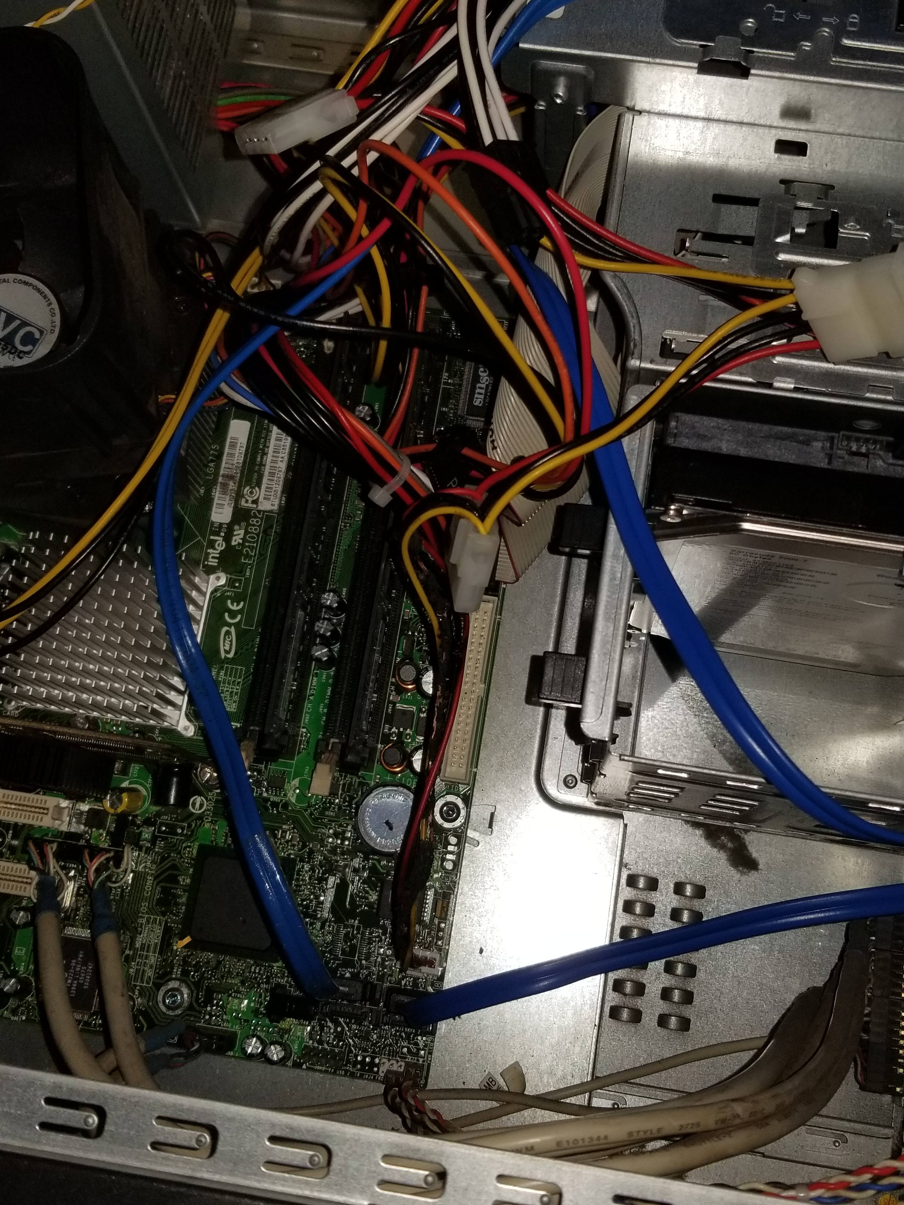

So to start, I am working on a coworkers pc. I get it plugged in and get 3 short post beeps which for an Intel mobo is ram error. I replace the ram, no post code, but no video either. I turned it off and tried again, post code is back. I take it apart clean it and put it back together. I plug in, turn it on and it's sounding so much quieter from cleaning. No post code, but still no video. I wait a sec since it's old, then I see smoke...
I immediately kill power and turn on its side to find the source, which turns out to be a power wire going to a molex chain and 1 Sata (not being used)
Has anyone had this happening and know how to Prevent it? Also for the video part, I'm thinking bad motherboard or gpu. Any ideas?

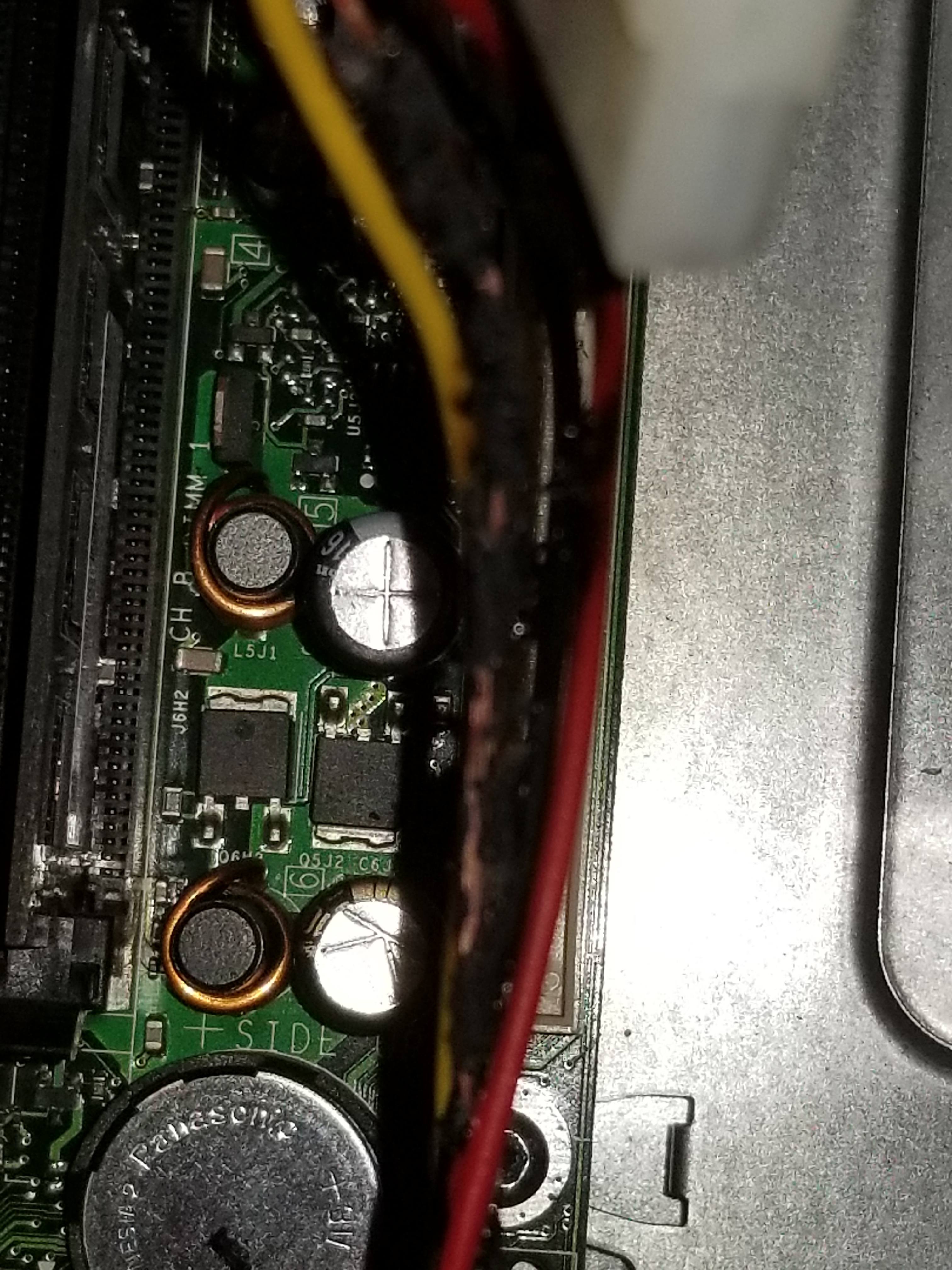

Disconnect that right away ... use some electrical tape to insulate that wire.
The insulation melts usually because the wire gets extremely hot, which happens when something is short circuited. Check and make sure no two wires are not in contact.

it's been disconnected, but i can't find any wires touching. Could this be caused by an old PSU? This is a 2011 gateway were talking about here, so i'm not assuming anything to be in great condition

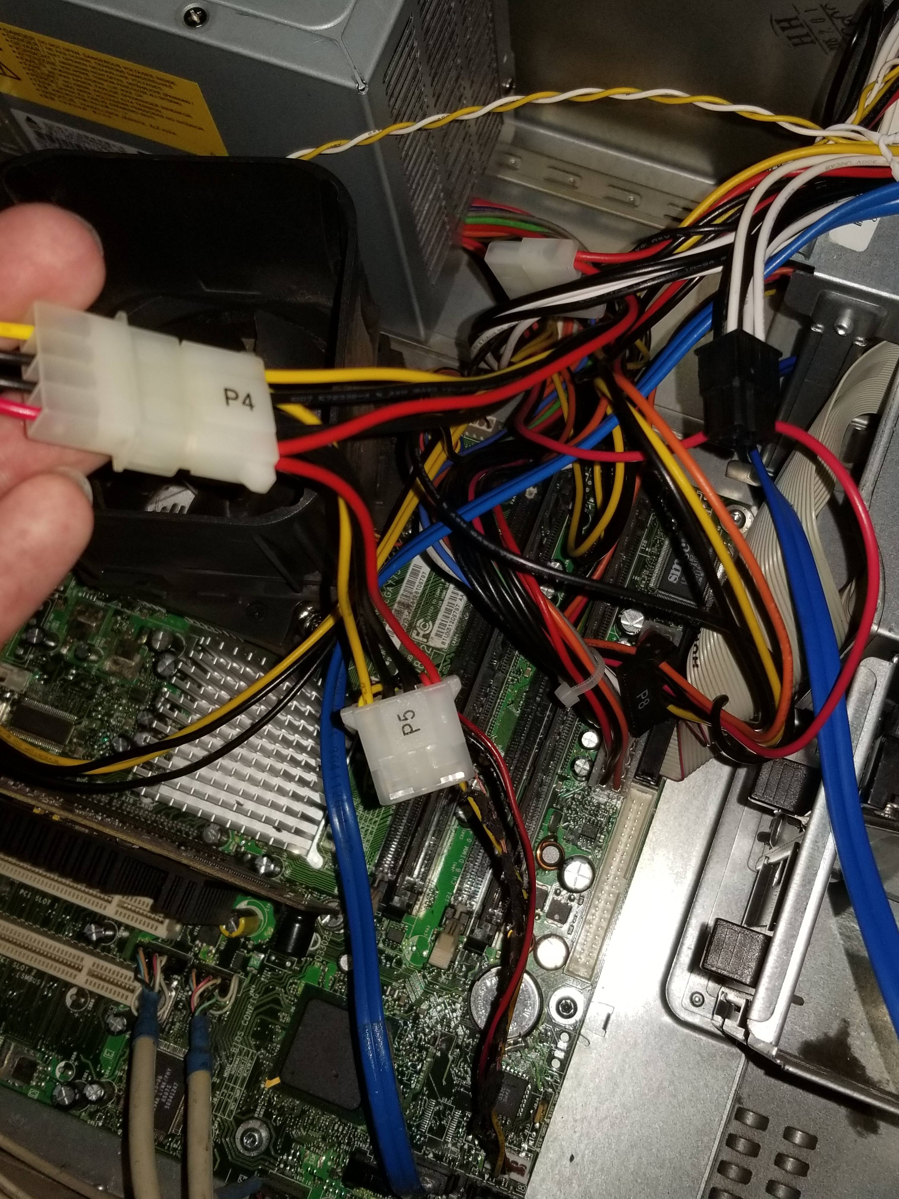

is that a berg connector plugged into a fan header?
i plugged that in where i found it, i hadn't seen that type of connector before and thought it was an older fan connector. That's probably the cause for the short circuit right? How bad am I screwed then?

Yeah, you have something connected in that fan header .... which is supposed to push energy from the motherboard to something. And you have a connector coming from the power supply going into that header pushing energy into the header ... it's like two people arm-wrestling, and the result is the weaker part (that cable) gets damaged by heating up
Maybe just that header is damaged , the psu could be damaged ... depends.
Unplug it, pull off the rats nest of splitter adapters. Try again. Hopefully it didn't fry anything important.
If you're lucky the reason may have been the PSU may have been drawn down so much it didn't post....

Yeah, you have something connected in that fan header .... which is supposed to push energy from the motherboard to something. And you have a connector coming from the power supply going into that header pushing energy into the header ... it's like to people arm-wrestling
This is why i hate old connectors that I don't know. I'm wondering how it worked before, maybe not plugged in fully.

If it is a berg connector it is a power connector for a floppy drive.

The top capacitor looks overblown & the lower one slightly bulgy , that bulging usually comes from  bad power draw from PSU, Had this issue on my old sempron ECS mobo, had to get it replaced & got it working again , you should probably try that , i had it fixed from a 3rd party, wouldn't recommend that you do it yourself.
i'm not sure if it's the capacitor, because mine was way overblown than this , like the screw grooves were barely visible kinda blown up damage.
To clarify did you replace the PSU or did you get someone to replace the capacitor itself?
did both, had some cheap Chinese nameless 400 watts if i recall correctly , it worked for more than a year perfectly, then it showed random shutdowns & power loss, i tested out the mobo on another PSU from a relative wasn't starting up still, had a repair guy do the troubleshooting & figure it out for me .
