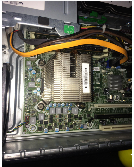

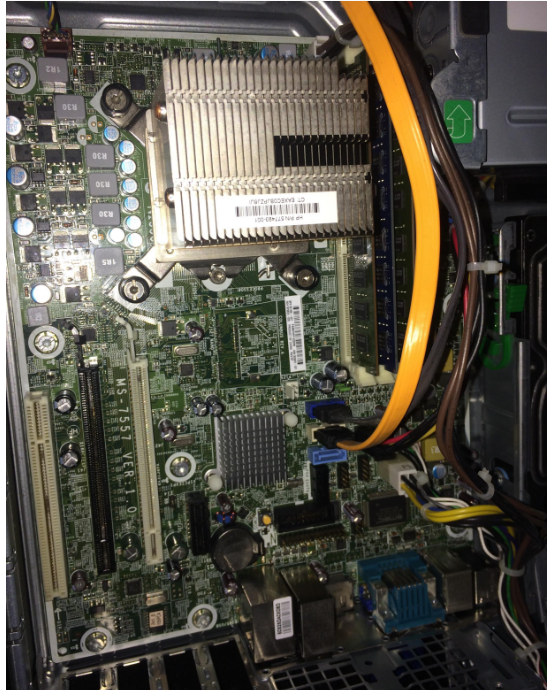

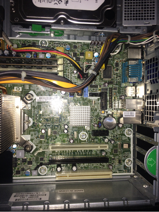

Hey guys so I had bought a HP Compaq 8100 sff that has an i5-650 and 8gb ram, but I wanted to upgrade it asap. But the thing is, I heard that the motherboards (some) are not-traditional/standard ATX/MATX size, I don't know much about motherboard size so I was wondering if anyone could identify whether this is an ATX or mATX or if it's some kind of factory-specific sized motherboard so I can get one that'll fit in a ATX midtower case. I want to re-use this motherboard in a different case so I was wondering if I could, provided that it's a tradtional/real ATX or mATX board.
ALSO (Extra help) - I need to upgrade my PSU because I want to get a 1060/1050ti, but I can't since this original HP case has a built-in/non swappable PSU, I want a FULLY-modular PSU at 450-500w's (AS CHEAP AS POSSIBLE PLEASE), and I want to know what's better for a low-VERY LOW MEDIUM size budget gaming PC... A 1050 or a 1060? What's better (obviously the 1060) but what I mean is what's most worth it for the money. I can get a 1050 4gb for 200$, but I could also get a 1060 3gb for 250$. Is the performance difference really that worth an extra 50$? I don't expect to play any games over 720/1080p, medium-high settings.
ALTERNATIVES - If someone could give me a budget build of around 300-400$ (excluding keyboard mouse monitor harddrive and ram, wifi stick and bluetooth stick). I am reallllllllly cheap too so lower = better for me

First forget upgrading the motherboard it is from Foxxconn you can only upgrade to a MOBO from an 8200 sff, or an 8300 sff, the PSU is also nonstandard and needs to stay, and also the fastest GPU you can stick in there is a 1050ti, you can also a 1050, or a 1030, for the 8200 sff MOBO you can grab an intel core i5 2500, and with the 8300 sff you can grab an intel core i5 3470.

First forget upgrading the motherboard it is from Foxxconn you can only upgrade to a MOBO from an 8200 sff, or an 8300 sff, the PSU is also nonstandard and needs to stay, and also the fastest GPU you can stick in there is a 1050ti, you can also a 1050, or a 1030. (still working on recommended CPUs0
I was going to buy a brand new case and PSU and a GPU but just move the mobo ram and storage to the new case... Is that a good idea? or just get a 1050ti?
(can i even use this mobo in a new case?)
https://linustechtips.com/topic/932668-need-motherboard-help/#findComment-11396407
Just get the 1050ti, though with that build a 1050 is a better option.
