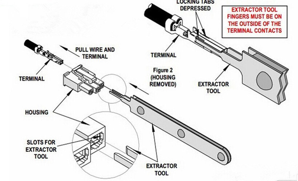

Get a proper terminal removal tool: https://www.amazon.com/Konsait-Modding-Removal-Computer-Connector/dp/B0171RDCWW
Image result for psu terminal remover

There's a proper tool for pulling out the individual cables.
The tool is shown here (Second from the left)

You need pin extractor, I suggest getting the official one made by Molex. Any 3rd party tool usually don't perform that great. Molex one will work every time without any issue.
Link: https://www.amazon.com/gp/product/B00GOIY1NE/ref=oh_aui_detailpage_o09_s00?ie=UTF8&psc=1
or
Link: https://www.mouser.com/ProductDetail/Molex/11-03-0044/?qs=%2fha2pyFaduilNHMC564LRU3%2fla3tDwRTxVkDOo4ce74%3d
3 hours ago, W-L said:
I would not suggest using that since the pin on the tool have to be tweaked almost every time before inserting it into the Mini Fit Jr. connector. Allot of 3rd party tools are like that, It's why you want to stay with official tool made by Molex.
or
Yes the original ones would of course be the best option some third party can sometimes not be the best, I've always made do with making my own pin removal tools from spring steel which has worked will in the past.
3rd party ones have a habit of damaging the terminals and the connector or they just don't work due to improper pitch.
It mainly has to do with getting the thickness of the steel prongs correct from what I've noticed, if it's too thick or thin it just won't work at all or bind up.
