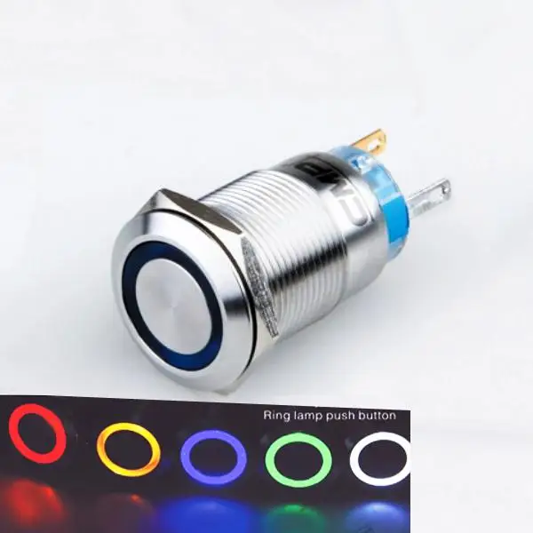

Kind of depends on the case (or really, the power button and LED). It would be easier to just replace the entire power button in most situations.
EDIT: If you went with an anti-vandal switch, it would likely look nicer too
Anti-Vandal-Switch-Momentary-And-Latchin
