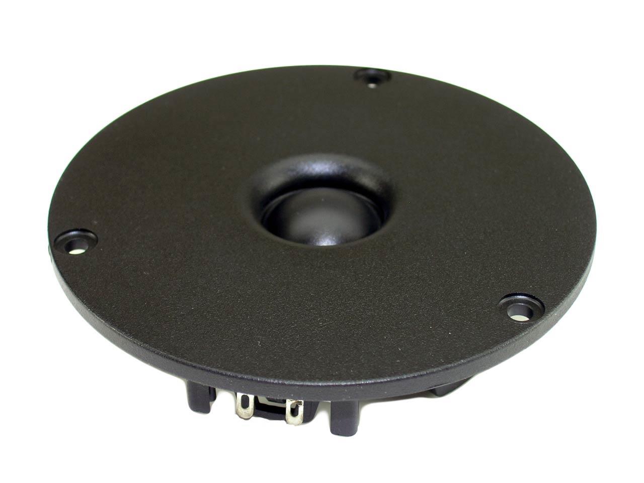

What do you mean by tweeter, and subwoofer?
This is what a tweeter is:
Image result for +tweeter
11 hours ago, rhyseyness said:
No idea how this sounds good :P You have no midrange
See, I took OP's post to mean that they had three 'high range' speakers (aka bookshelf speakers or satellite speakers from a previous 2.x type system) and a sub (either from an x.1 system or stand alone) rather than literally three tweeters/compression drivers and a low range driver. Possibly OP is from the world of cars, where tweeter is used wrongly and more often as a term for a non-low range speaker.
Alternatively not an English native or familiar with the English terminology.
Or has a very strange setup.
