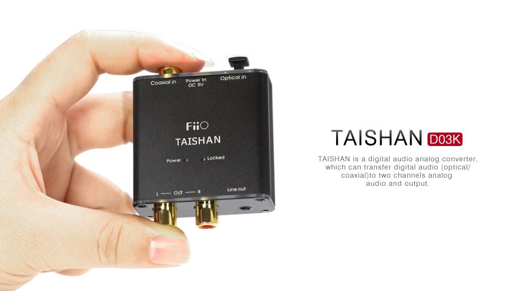

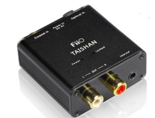

Fiio TAISHAN will convert optical to 2 channel RCA or 3.5mm out. Pair that with the splitter @CoolBeans suggested. Probably not the most elegant solution but it should work.

the D3 doesn't output to 3.5mm, only RCA. my mistake. The TAISHAN outputs to both
