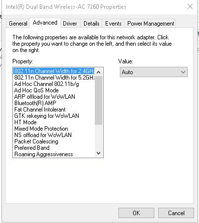

Can you see some kind of a gaming mode in the dongles properties:
Cause i had lag spikes with my asus pci-e wifi card and they stopped when i enabled the gaming mode in the advanced properties
I couldn't find a option similar to that.
