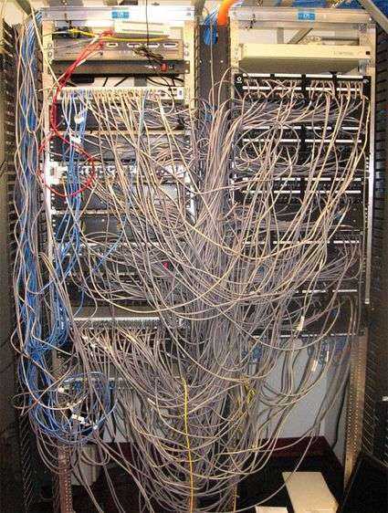

4) Sure you heard this before but, CABLE MANAGEMENT. I don't care if it takes forever, label cables, tie them into groups. Trust this me makes it easier if your core router goes out, or a switch randomly calls it quits (especially if you have 10-20 switches deployed). If you're making your own cables remember this. Measure twice, cut once. Datacenters/Server rooms can't afford to have slack/excess cable around. And it makes cleaned up much easier
So.... like this?
