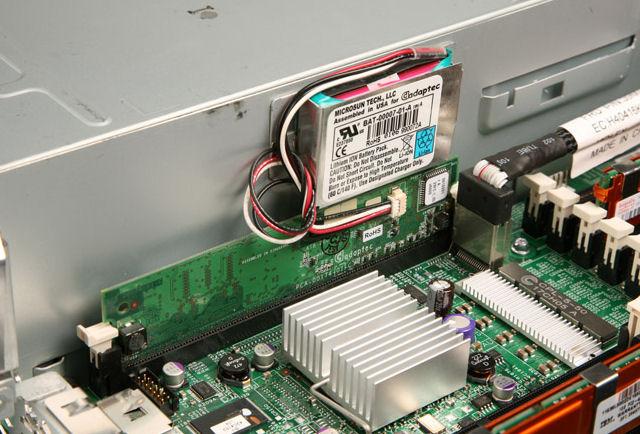

I am a bit of noob here, just starting out with servers
I bought a X3650 IBM server
There is one DDR1 slot with a RAID card in it  (i think) Then there is lots of slots of DDR2 for the ram.
I do not need speed or any raids.
Some images below to help
Big Pictures....
There is PCI riser so if need be i can plug in a low profile PCI raid card.
Also i am running vMware as main OS.
Will this one do and fit the existing connector?

Ah, OK. IBM has a site for identifying their old SAS controllers here. I think it could
be an 25R8064. In the description for that one it says that the label has 25R8076
printed on it, which yours does, and the ATB-200 descriptor matches as well.
ServeRAID 8k SAS Controller
Part number: 25R8064
Year of first availability: 2006
US Announcement Letter: 106-379 (announced with the System x3650)
Features:
  • 256 MB DDR2 533 MHz
  • Enables 72 hours of battery life for 3 years at 45°C
  • RAID-0, 1, 1E, 10, 5, 6,
  • Copyback
  • FlashCopy
  • Stripe-unit size: 16 KB, 32 KB and 64 KB, 128 KB, 256 KB, 512 KB, and 1024 KB
Visual identifiers:
  • The option is shipped as a special memory DIMM with a battery attached through wires (for battery-backup purposes)
  • The DIMM is installed in a special DIMM socket in supported servers
  • Five DRAM chips on the DIMM
  • FRU on label is 25R8076; Stamped "Adaptec ATB-200" on battery side
  • Write-back cache memory is 256 MB, 533 MHz DDR2 unbuffered memory
  • Battery is connected to the DIMM by wires and is typically mounted on the server chassis
Figure 19. ServeRAID 8k (battery not shown)
Figure 20. ServeRAID 8k installed in an x3650
Just in case you were curious.
As for installing another controller: What you need for that one (and yes,
that one does support drives larger than 2 TB, I have three of those running
myself) is a PCI-Express 8x slot. The 9211-8i is PCI-E 2.0, but in general
PCI-E 2.0 cards should be compatible with PCI-E 1.0 motherboards AFAIK. It
doesn't have a cache, so your performance won't be too fantastic, but it does
provide some basic functionality for a decent price and is a good piece of hardware
(I'm using them with software RAID, works very well).
I'm not really familiar with proprietary rack server hardware though, so maybe
@Whaler_99, @wpirobotbuilder or @IdeaStormer might have some additional
insight here which I might have overlooked.

The ServerRAID 8x does not support driver greater that  2TB : http://www.tomshardware.com/answers/id-1798481/ibm-x3650-7979-raid-card-upgrade.html
I would go for the one suggested in that link, the "IBM ServerRAID M5015" http://www.redbooks.ibm.com/abstracts/tips0738.html
