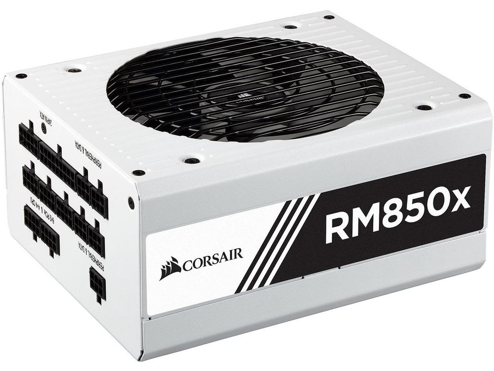

37 minutes ago, Zeroo said:
RM850x White - has almost same fan curve as HX850
Seems better than normal RM850x
Doubt it's worth 30$ extra for HX over RMx?
BTW: white and 2018 normal cost same here.
In that review, that's the white version of the 2015 RM850x, which was a costdown version of the HX850.
The white ones that you'll find on the market today are the white version of the 2018 RM850x.
You can tell the difference by the size of the unit (2015 is larger than 2018) and the modular side :
2015 :
2018 :
To be clear, the 2018 RMx still is one of the most quiet PSUs out there, going for HX solely for quietness probably isn't worth the premium.
