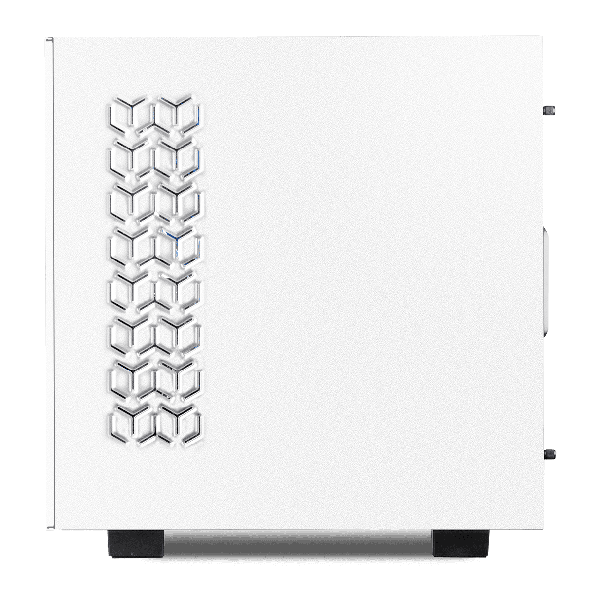

Upgraded over Christmas to an i7 9700k. I have a Corsair H115i AIO in an IBP Snowblind S Case. Prior to my upgrade, from an i5 8400, I would sit at 70deg under load. I have noticed even if I leave my PC on during the day it ends up in the high 80s, low 90s even at times. Mostly when it creeps into the 90s, it will be under load, but I have caught it in the high 80s just idling. If I sleep my PC during the day, when it runs for a few hours under load when I am home, it sits in the 70s.
I have dusted it a few times since, even reseated and pasted my CPU.
Do I need a new AIO? Do I need to switch to a CPU fan? I have debated hardline water cooling, but now with the Snowblind S, I would hardly see it. My GPU rarely creeps over 50.

The iBuyPower Snowbird S has pretty poor airflow.
Your ONLY form of air intake is the RESTRICTED side panel.
The front is COMPLETELY closed off....and no ventilation at the top of the case.
Only other form of ventilation is the single rear fan spot.
The CPU temperature slowly climbing higher the longer the system is on would indicator airflow issue.
Hot air / heat is not being removed out of the system fast enough, and "heatsoaking."
Temporarily remove the glass side panel, and see if there is much change in temperature (i.e. 5*C or more).
If you see a significant change/drop, it would confirm airflow issue.

It looks like the iBuyPower version does not have a ventilated bottom -- appears to be completely closed panel, minus the  vents for the PSU.
The side vents is helluva lot more restricted than the InWin 301 that you have -- they look like just tiny 1 or 2mm cuts...
Fan set-up and CPU block mounting is a good-to-know as well.

The side airflow slots are actually bigger than they seem in the photo. it actually does unload a fair bit of air, but I am currently using it as intake, as I have an AC unit on that side of the PC.
