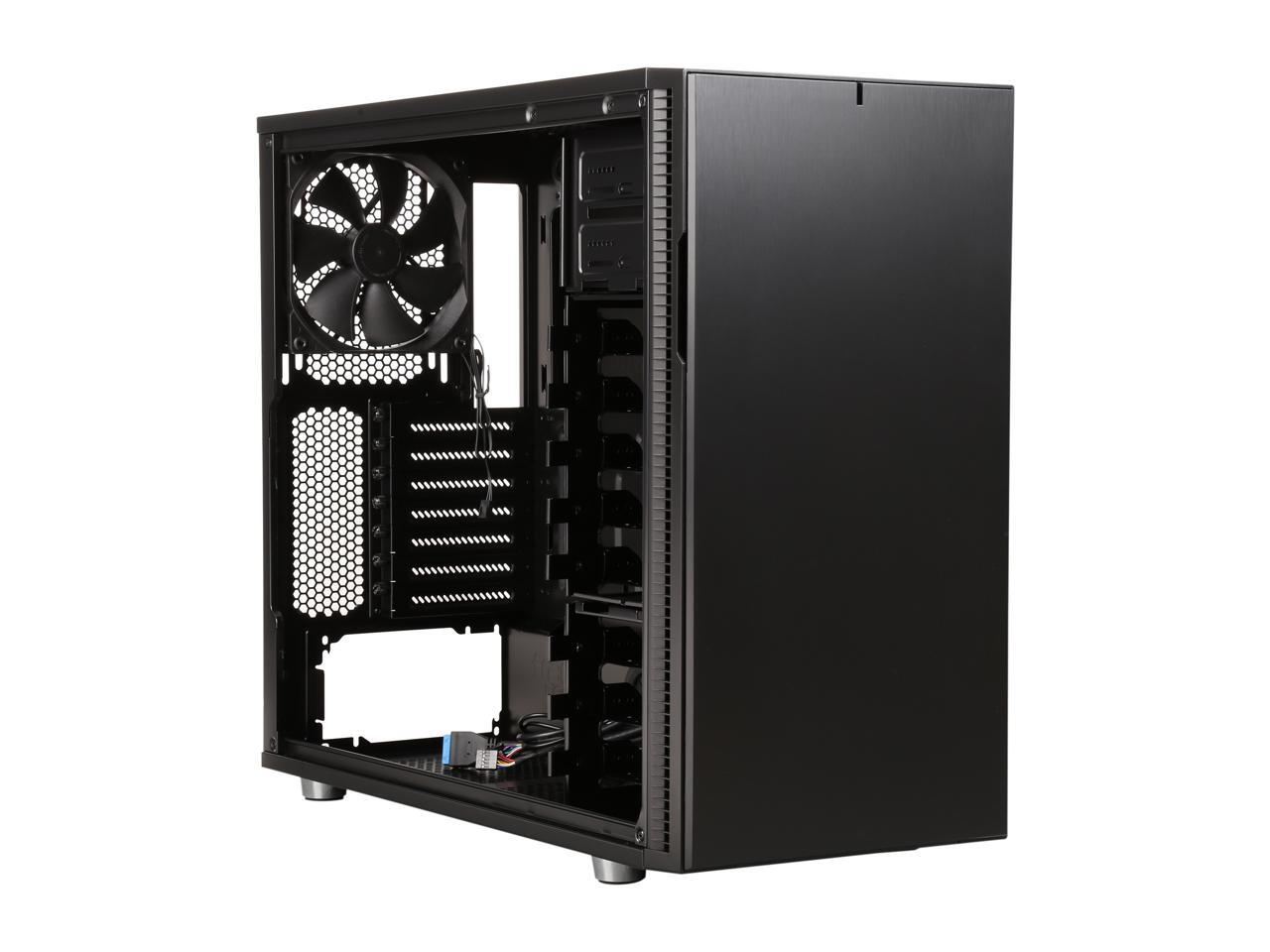

Hello i have Corsair H80i
Corsair Hydro Series H80i V2 Water CPU Cooler 120mm - Newegg.ca
And this case
Fractal Design Define R5 Blackout Window Silent ATX Midtower Computer Case
https://www.newegg.ca/p/N82E16811352057?Item=N82E16811352057
Today i watched this video
And i notice even corsair seem to position their cooler wrong even in their pictures and videos installation. As far as Gamers Nexus says...
I was wondering if my position is wrong for real and how should i position it?
I'm kinda confused because if i remember i installed it the way it fitted the better in the case... and the corsair logo is not upside down or sideways.
This is my setup, please don't mind the dust i know i need to clean it lol
There is 2 pci cards for firewire and more usb ports, don't mind that i know its ugly but i need them.
https://linustechtips.com/topic/1271935-corsair-h80i-position/
Your AIO is positioned fine.
Air will generally rise to the highest point of the loop. It should be good as long as the highest point isn't at the pump or tubing.
https://linustechtips.com/topic/1271935-corsair-h80i-position/#findComment-14233589
did you make sure to watch the whole video?
your radiator positioning is specifically what he said was basically best for a radiator. the tubes are on the bottom, so air will float to the top of the radiator.
Ah ok.. i thought he said the pump cables at the right of the cpu was problematic
I remember the note about the tubes above the pump but not on the side
although I also remember that his most important note was that it's not the end of the world
