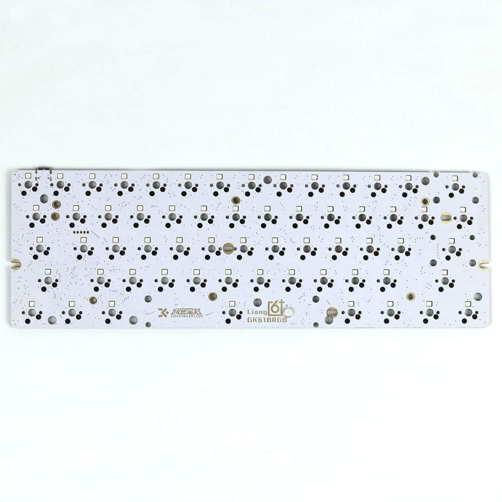

Ok so after doing some research i have learned that it gk61 supports both plate and pcb,
I might stick with the installed ones but lube em up real nice. especially after reading that it makes it more secure
Are you sure about that?
I'm pretty sure it's Plate mount only.
3 hours ago, sowon said:
The PCB & plate on the GK61 use proprietary mounting standoffs so you will have a lot of trouble changing out the case, unless you choose a new case that is designed for the GK61.
Although I don't think this is correct. I looked at the PCB and it seems to have the standard mounting points.
It's far from standard.
I can't see the PCB in this shot. The one I've seen looks like the one seon123 posted above. Can you look at the back, it may also have standard mounting holes. Other wise there are apparently different versions of it floating around out there.
it should, it's a tray mount, you should be able to just screw the pcb onto the stand offs. But if you're using a hotswap pcb always use a plate.
EDIT: NVM, it uses plate stabs, so no you can't use pcb mount unless you don't want stabs.
