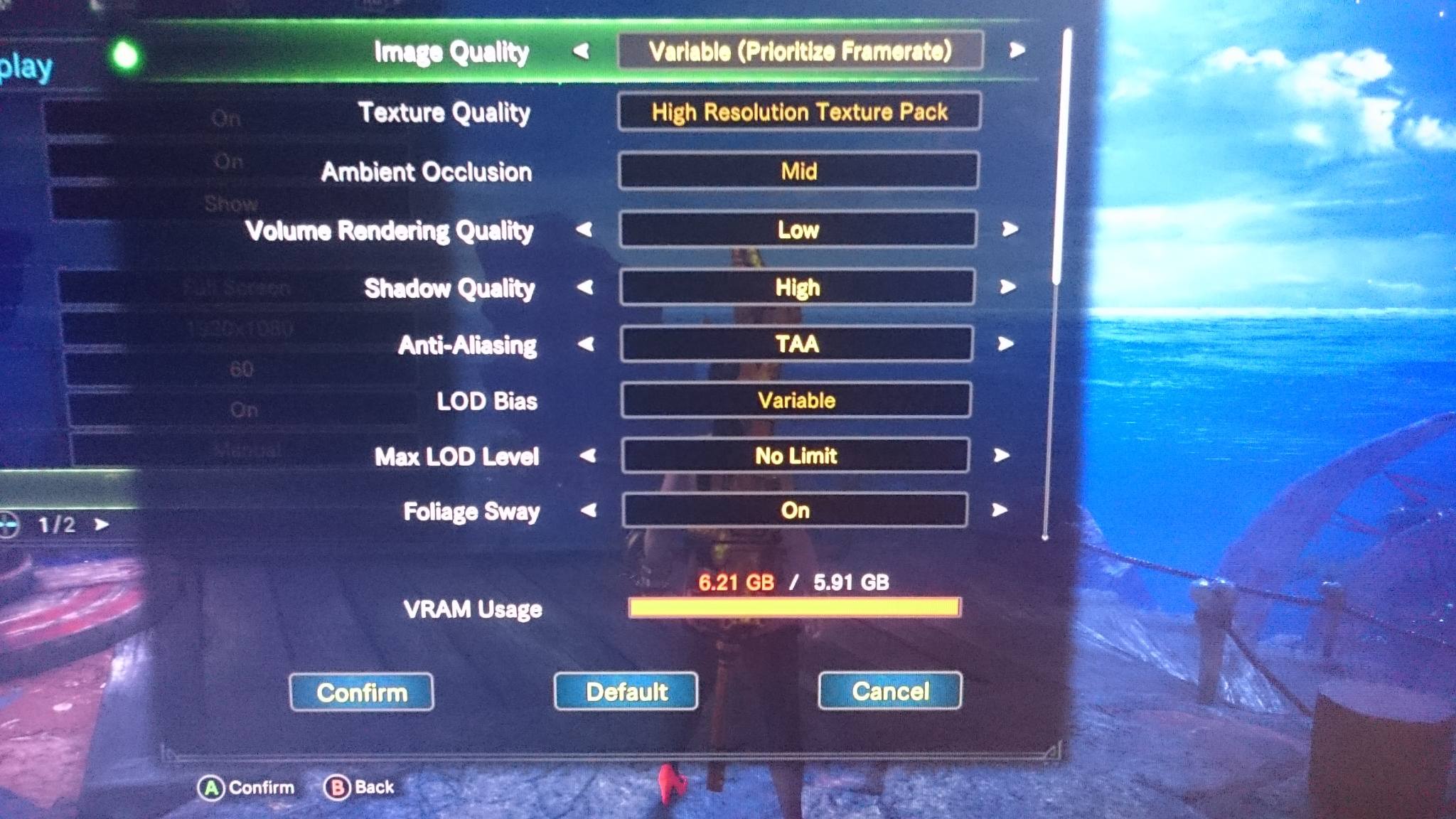

Might have to do with the fact I'm running at the absolute maximum this card can do (game uses 6.21GB of 5.91GB available!)  but at least it still works pretty well,  I just have to set it to max performance apparently (which makes the PC like 10% or so louder while idling)

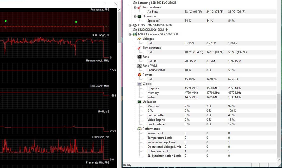

(note the two green points are the start and end of the quest, aka loading,  it's normal it drops there obviously)

I'm aware.  Capcom's are frighteningly correct though.
I shouldn't even be running this texture pack - but it looks so good and it works,  mostly!   :)  (minimum requirement is 8GB VRAM iirc,  it's more than 6 anyway)
