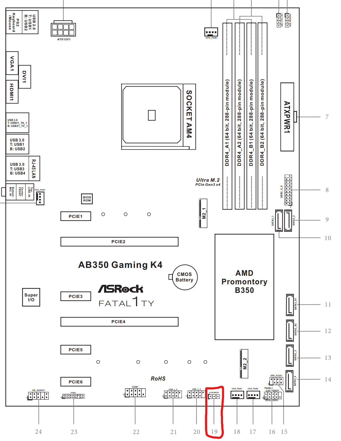

Position of the header:
keep in mind this will reset the BIOS, which basically only means; you memory and CPU overclock settings will reset, possibly your boot order will reset and that's about it.
Since the DRAM light is on, I am almost suspecting this is a bad RAM OC. If this works: run a memtest on your PC. If this doesn't work: try either memory stick, one by one in slot A2 (that's the second slot, counting from the CPU socket side to the right).
