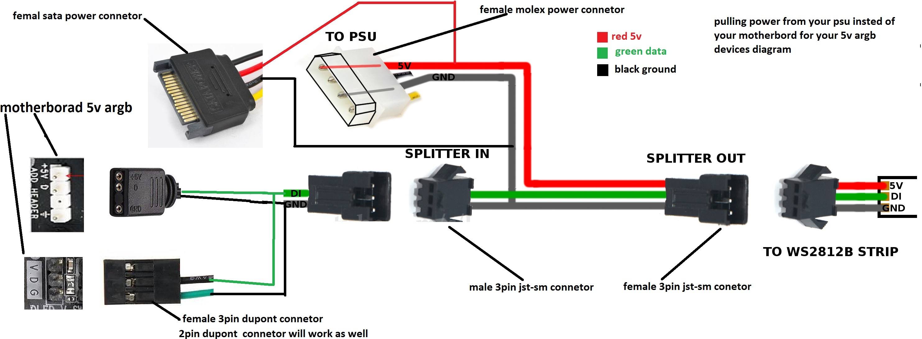

to start rgb is normally 12v and argb is 5v so no mixing them. rgb all the leds will be the same color and argb each led can have its own color. depending on how many fans and how long your rgb strip is pulling power from just the mb is a bad idea and you have to find out how much your headers and handle. that being said i no with 5v argb you can pull power form your psu instead of your mb that will bypass the power problem. as for having rgb strips out side your going to have to run cables out side the case and make your own cables. if the strip is too long you might have to add in power here and there or even a data repeater. there are kits to do room but you want to sink with your pc so this is how it be done.

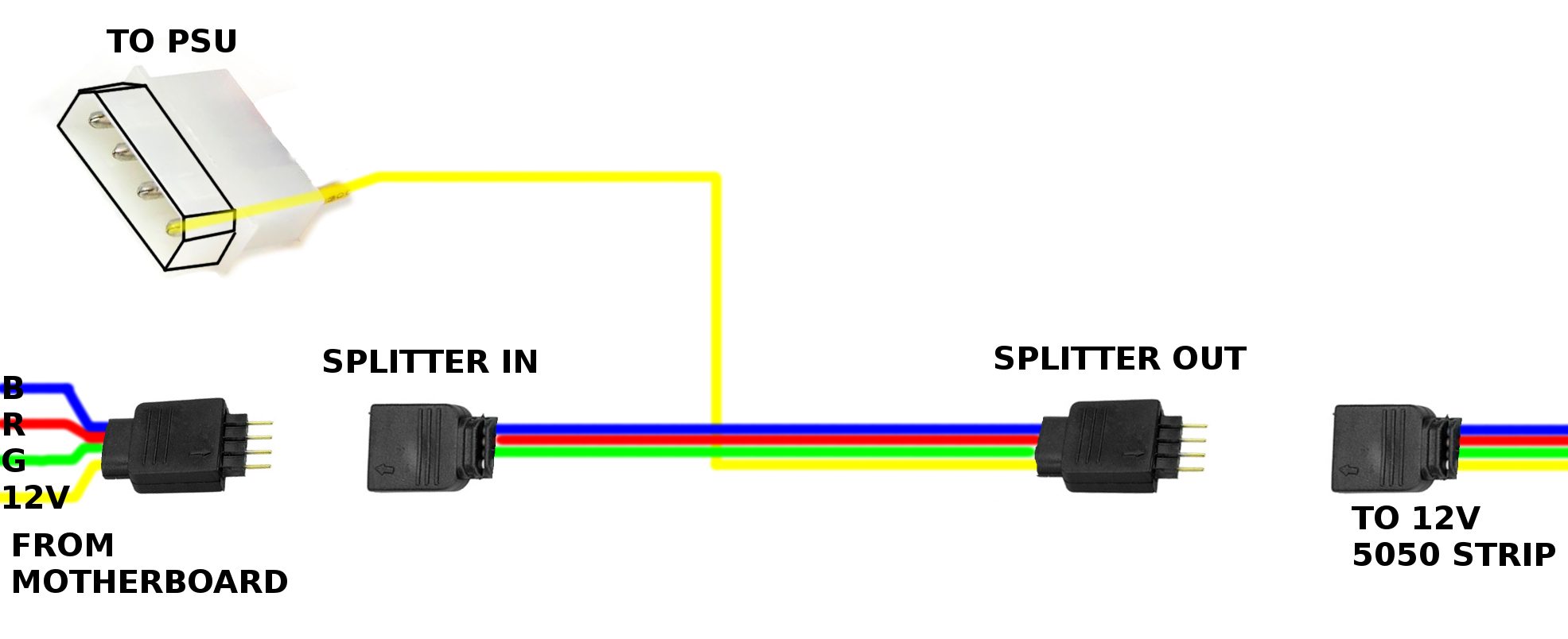

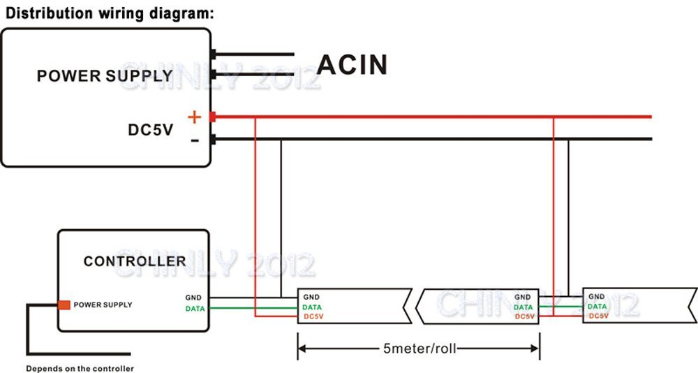

i found the diagrams i wanted to show how its done. also to keep in mind that asus rgb software might only suport so many leds so keep that in mind as well.
