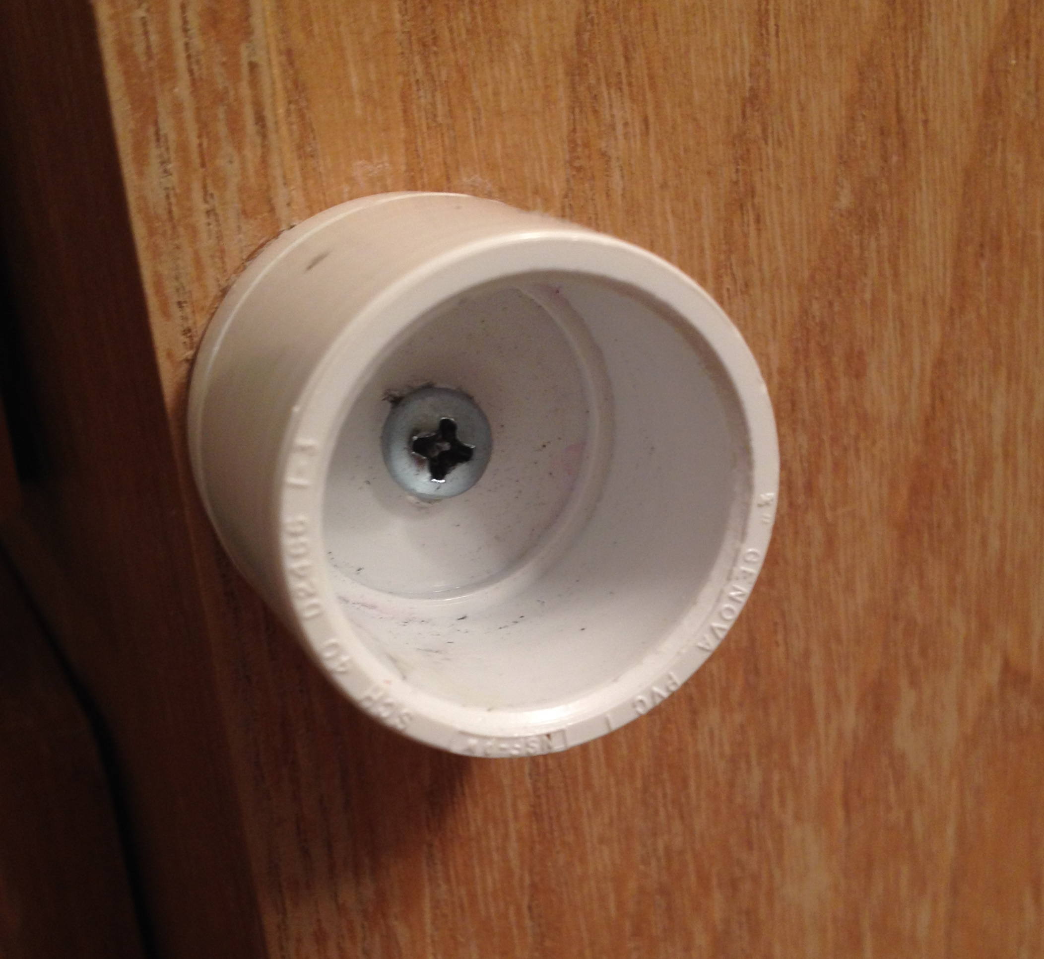

Step 3: Make a small hole in the center of both 3/4" Caps, I used a drill with a 1/8" drill bit for this, But you could use a nail and hammer it through the cap, just make sure you do it somewhere that the nail won't damage whatever you have the cap sitting on.

Mount one of the 3/4" Caps to where ever you want one end of the hanger to be, I screwed it to a cabinet using a #8 Pan head sheet metal screw*. You will need to measure how long your hanger is, and mount the other cap where ever it needs to be to fit the other end of the hanger, If what you are mounting it to is thin wood cabinets, try to mount it to an area that is stronger, I screwed it on where there is a shelf on the inside of the cabinet so that it screws into the wooden shelf and not just the thin cabinet wall.

Step 6: Slide the ends of the 3/4" Bushings into the mounted caps, Elbow going up, and that is it!
