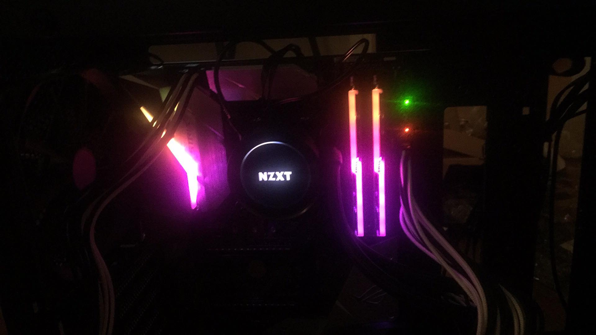

Hey guys taking me the whole day but i got my pc to run , just tested it now, However i have a question. So when i plug the psu into the wall the lights automatically turn on you can see by the pic below (Just the motherboard light on the left and a small red light on the right.
Then when i turn on the power everything runs perfectly, ram lights up, the aio is working, fans spin etc etc I went into the bios to check , all is working, everything is detected by the system. I turn off PC as i still need 2 plug in graphic card, sort out cable management etc but the lights are still on as you can see by the pic and i dunno if this is normal and what that little light means on the right hand side.
When the pc is on anther light appears above it and its green. Again i dunno if im stupid or something but any help would be great , its taken me a whole day to get this far but im happy its working

The lights being on is normal. Switch off your power supply before plugging anything in

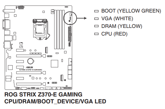

Found something for you looks like something is wrong with your boot device.
I dont have any OS on there yet i just wanted to check if it was working, it that the problem? I just have my m.2 drive in there but the mob can see it fine
