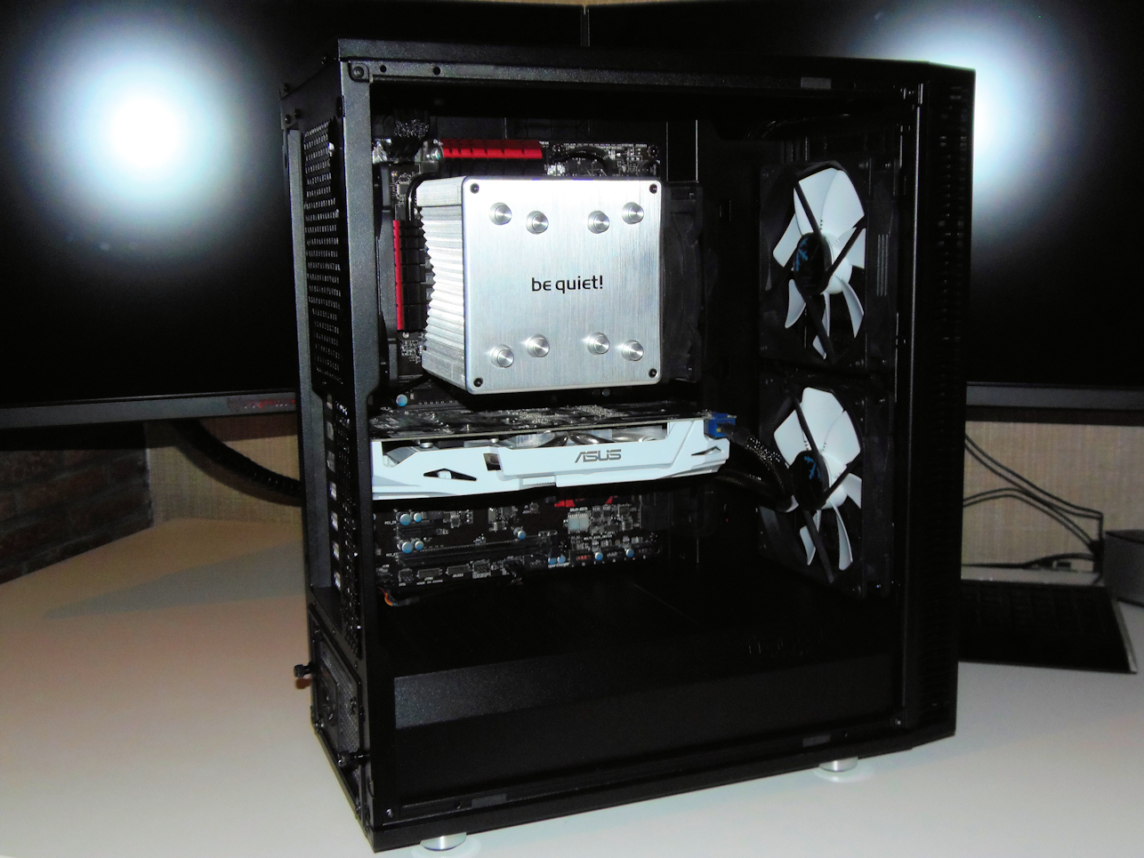

On my own Define C (same chassis, more restrictive front panel) I went for dual 140mm in the front and a 120mm exhaust in the back, with the top panel still on.  Looks a lot cleaner due to being able to keep the shroud's panel closed and the fans are positioned perfectly for the internals.
Sorry for the dark pic, I really should take some daytime pics sometime soon.
That's an i5-2500@4.1 and a 1060 3GB.
Temps for this setup never exceed 50°C on the CPU and low 60s on the GPU.  the Ryzen will probably run a little hotter, but a Meshify C should be able to handle that just fine.
