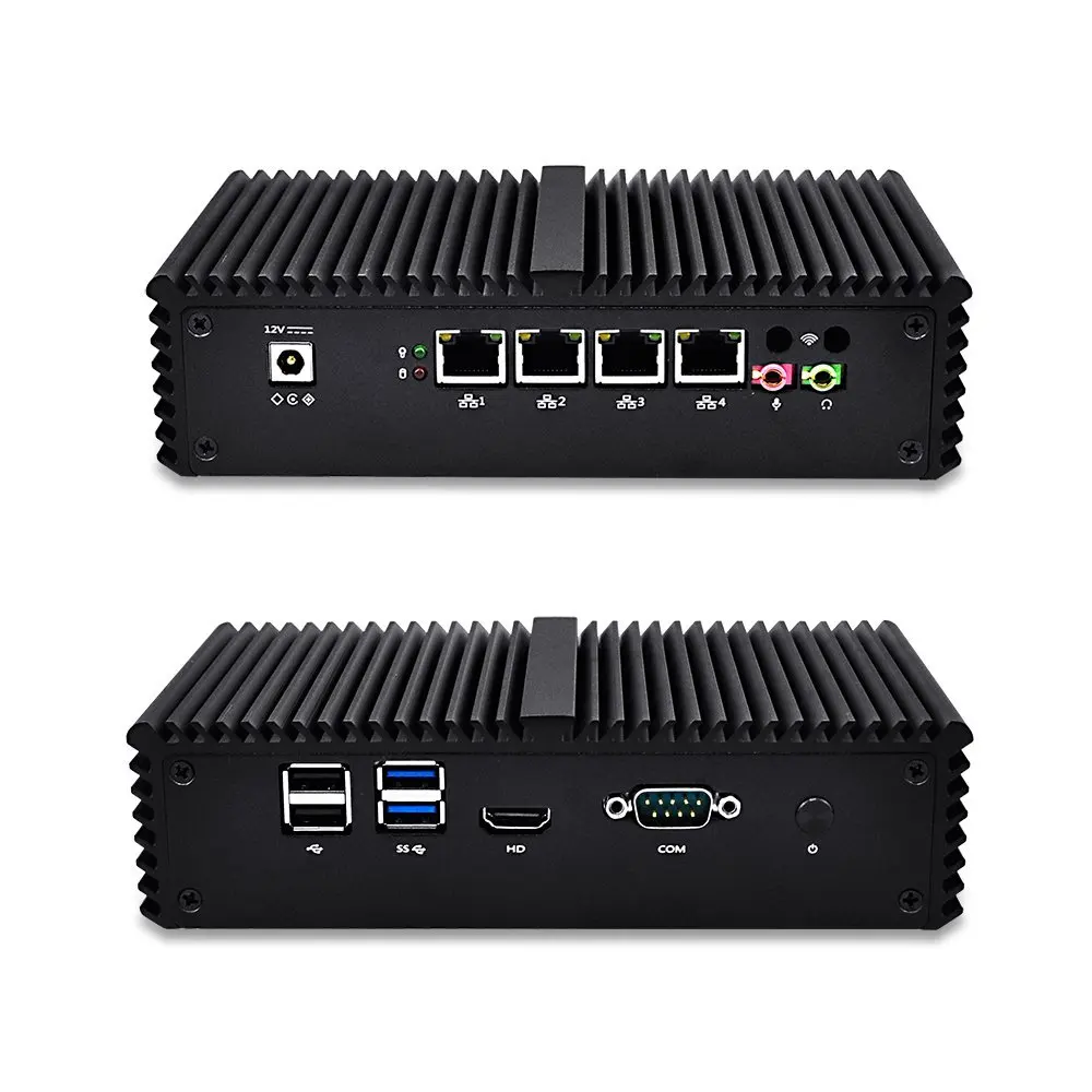

Buy a router you can install pfsense on and just start doing stuff with it. I mean, you can read everything on the web, but reading it and understanding it is a completely different matter. I think you're better off getting some hardware and actually play with it and try getting it to do stuff. Like setting up a VPN.
I have a small router running a i3-4025U, 4gb ram and a 60gb ssd with pfsense running on it. It's enterprise level router software and free. Otherwise you need to take some sort networking education because this shit get's complicated really fast.
I have something like this.
Kettop-Promotional-Pfsense-Mi4005L-Intel
https://www.alibaba.com/product-detail/Qotom-Q335G4-AES-NI-Mini-PC_60764993778.html?spm=a2700.7724838.2017115.11.5574a077VWAqkK&s=p
