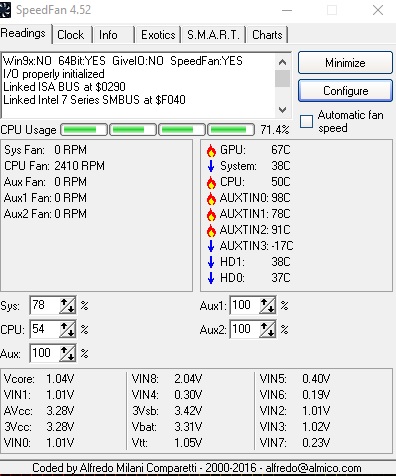

Honestly, that isn't bad by any means. If you are concerned I would first double check and make sure your fans are set up to push/pull air in the most efficient way possible. Additionally, make sure your cable management is as good as you can get it. Past that, you might switch to watercooling your GPU.
https://linustechtips.com/topic/941724-pc-getting-too-hot/#findComment-11479305
Those temp readings are wrong for the AUX sensors. I wouldn't worry about those - they're sensors that either aren't read correctly or just unused(particularly when the last one is reading -2C). What GPU are you using in your build? Even so, all temps are totally fine.
https://linustechtips.com/topic/941724-pc-getting-too-hot/#findComment-11479308
Going to need a bit more info here, What are your system specs?
Also try HWinfo instead of speedfan.
99C is bad.

4 minutes ago, sazrocks said:
99C is bad.
I'm doubtful it's a real reading.
https://linustechtips.com/topic/941724-pc-getting-too-hot/#findComment-11479336
Which is why I recommended OP to try HWinfo to confirm. If, however, it is a real reading then it is very concerning.

1 minute ago, Brandon Knibbs said:
Intel(R) Core(TM) i5-3470 CPU @ 3.20GHz (4 CPUs), ~3.2GHz
16gb ram ddr3
Msi nivida geforce GTX 1050TI
ASUSTeK COMPUTER INC. P8B75-M LX motherboard
Is the GPU temp in the snapshot showing the temperature shortly after a high usage workload?
https://linustechtips.com/topic/941724-pc-getting-too-hot/#findComment-11479354
No when it is in full load usually when gaming it gets up too 70c-80c
Are the fans off on the card?
https://linustechtips.com/topic/941724-pc-getting-too-hot/#findComment-11479381
the fans come on after it hits 60c
Okay, you're good then. Those crazy readings you have with the AUX sensors, I would just ignore. But see what HWInfo and/or HWMonitor have to say as well.
https://linustechtips.com/topic/941724-pc-getting-too-hot/#findComment-11479392
The auxtin readings are from faulty or unused sensors-- ignore them. The rest of your temps seem fine.
https://linustechtips.com/topic/941724-pc-getting-too-hot/#findComment-11479410
21 minutes ago, Brandon Knibbs said:
i have changed the image becasue i took this one while gaming
They're still fine.

20 hours ago, sazrocks said:
99C is bad.
Its 50C on CPU, 67C on GPU. Rest of sensors can be ignored.
16gb ram ddr3
Your temps are fine for those specs. If CPU goes much over 70-75C under load, consider changin thermal paste. Stock cooler is enough for CPU, but paste isn't the best.
