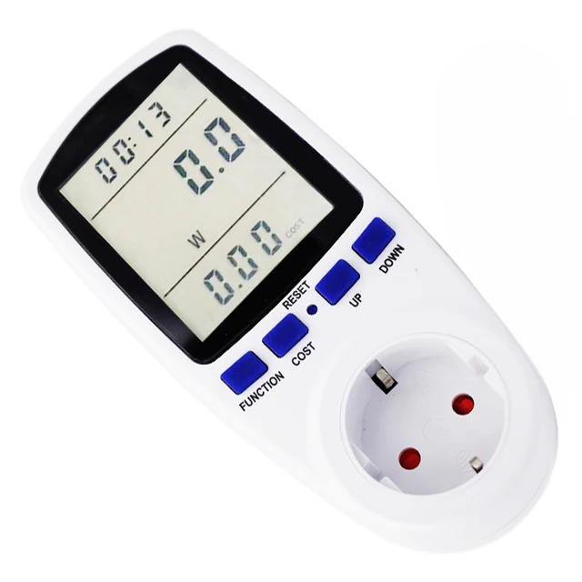

Get a digital wall socket tester. However, it will measure full system power use. Have you tried using MSI Afterburner and turning on the power consumption measurement. For example, my RX 570 4GB when properly tuned pulls 70-80W, which is confirmed when I did proper testing and calculations using the wall socket tester. You can see it in the image below.
digital-watt-meter-European-power-measur
