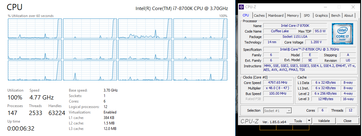

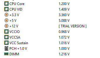

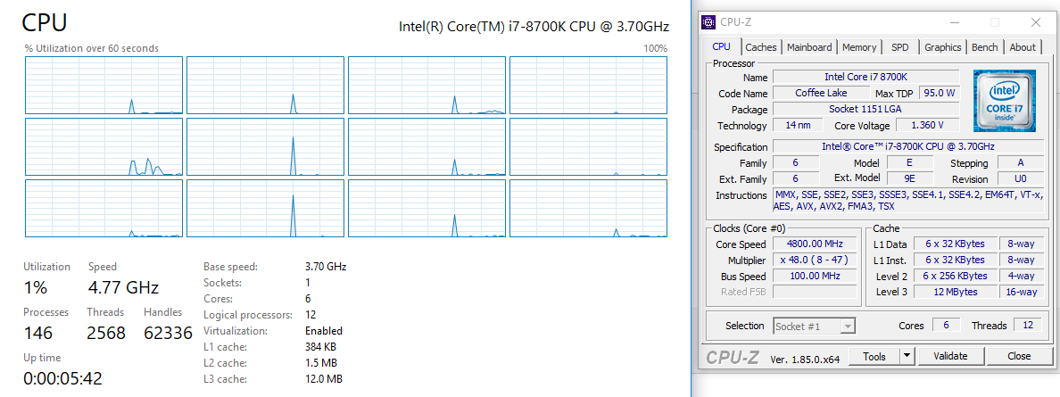

Seems a bit odd my core voltage at Idle vs cine bench load with my i7 8700k at 4.8ghz
Cpu is at 1% usage (Idle) at 1.36v
Cpu's running cinebench core voltage at 1.2V
Overclock is manual
All core  = 48
offset voltage at 10mv
MCE = off
Its odd my temps are at 35-40 idle and 75 max under full synthetic load

4 minutes ago, SpiralTTGL said:
asrock extreme 4
i think it's maybe because you're using Offset mode instead of Fixed mode, but anyway 4.8ghz at 1.2v is insanely good.. you can probably even go lower than that :D
Thing im worried about is the 1.36v at idle dont understand why its so high compared to load

Just now, SpiralTTGL said:
Thing im worried about is the 1.36v at idle done understand why
because offset is just offsetting the stock voltage, if you set it to Fixed you'll get the voltage that you want.
