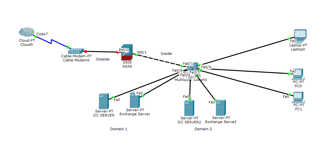

I have 2 Exchange servers for 2 separate domains. The Exchange server on domain 1 is being port forwarded to the ASA. What I'm trying to achieve is I want the emails for domain 2 come from The exchange server in domain 1 into the Exchange server of domain 2. I've set up send connectors and and receive connectors. But I'm unable to receive, I can't only send.
Network diagram :
https://linustechtips.com/topic/915289-exchange-server-help/

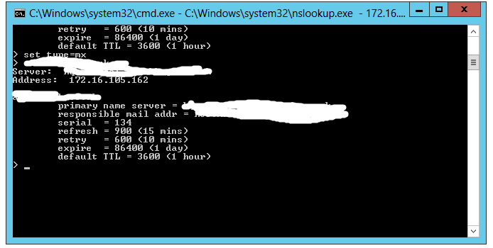

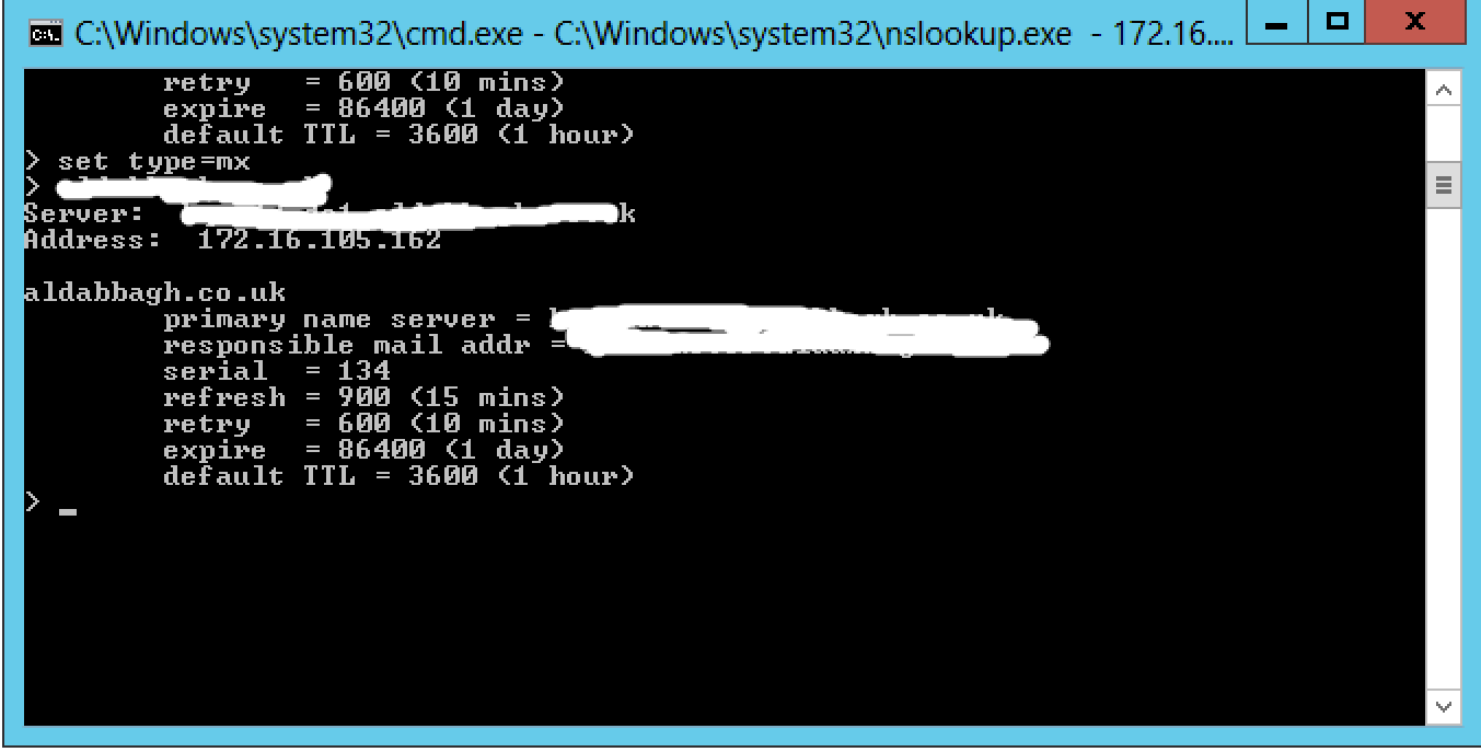

1 hour ago, leadeater said:
On Exchange 1 open up nslookup and do an MX record looking for the Exchange 2 domain, make sure internally you are getting the internal IP address for Exchange 2 and not your external one. If Exchange 1 sends it back out to the public IP the forwarding rules on your routers will just send it right back to Exchange 1 and it'll never get to Exchange 2.
This is what i got:
https://linustechtips.com/topic/915289-exchange-server-help/#findComment-11230423
15 minutes ago, leadeater said:
Does the primary name server resolve to an internal IP or your public one?
Internal IP address.
