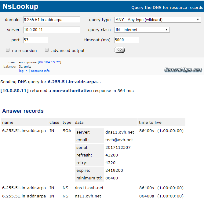

I'm having issues with my Reverse Lookup Zone. I have a VPS (windows 2012 R2) which has an IP of 51.255.6.168. I've creating the Reverse Lookup Zone. When try to point the server to it, it says "A new record cannot be created. The IP Address is invalid"
Please help. :(

That's how it is. It can be removed. I tried to remove it.

Okay. I created another zone using 3 octets. It worked when I added the ptr.  When I try to resolve the ptr using online tools it goes back to dns11.ovh.net.
does that mean I can do anything?

Right I should have noticed that it was a public address. So unfortunately you won't be able to configure PTR records for any public address assigned to you since you are not the authoritative owner of the IP address, your ISP is and the PTR needs to be set by them or forward to your DNS server.
