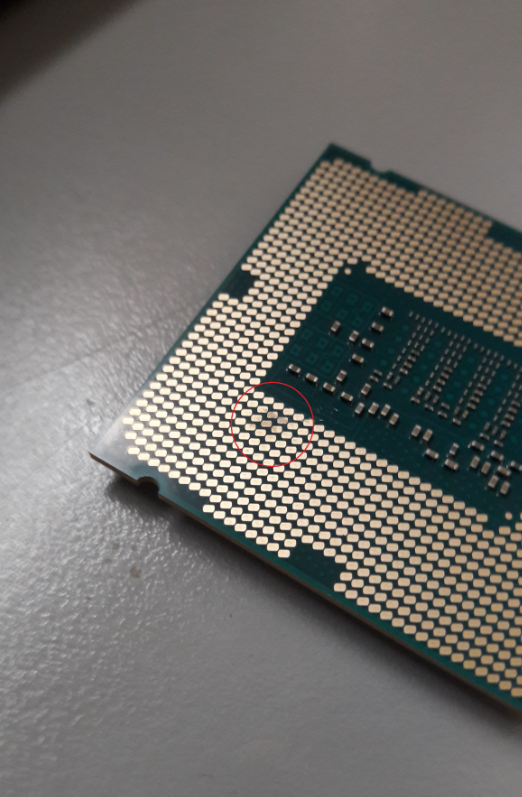

Hey, I just wanted to ask if the contacts behind the CPU ( the gold parts ) have a small smudge on it will it affect the performance? (Core i7-4790) Couple years ago I was upgrading my PC from a i3 4170 to i7 4790 which was a 2nd hand CPU. I then accidentally got a bit of CPU grease on the contacts. :$ It was light smudge. So I slightly wiped it off with a suitable material. So then I tried to sell it off to CEX a UK company that buys electronic goods and told me there's something on the contacts. Now I'm wondering cause of the smudge on the contacts could that be affecting my performance when playing games? And it there a way to wipe the smudge off properly? Here's a picture: 376f6e2d0f9858e22e04b942602376af.png

I'd also try to clean it carefully with some iso-propyl alcohol (rubbing alcohol). The pads are usually gold plated I think, so they should resist oxidation. It could affect signal integrity, but generally it either does or doesn't do enough to affect working. It isn't going to make it slightly worse. It could potentially be worse if it was on enough power pins. Trying to push too much current through it could result in local heating.
