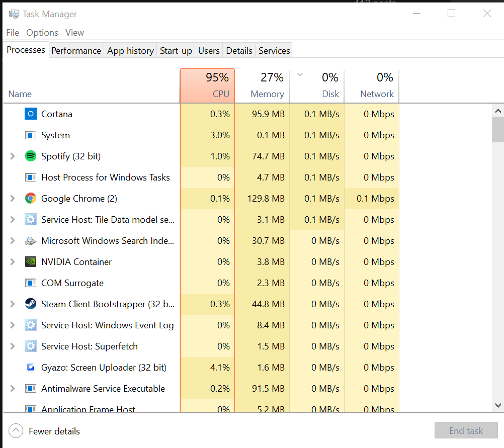

Overall usage seems low but I have a lot of random things loading on start up.. I should probably get some of them to quit.

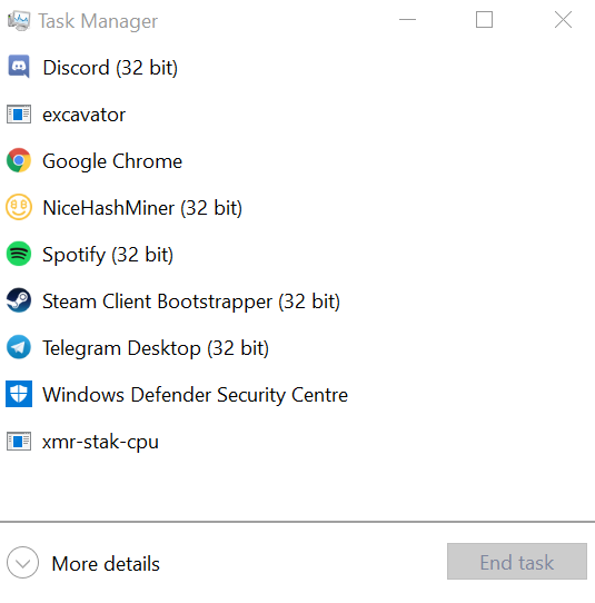

This is what it looks like now.
