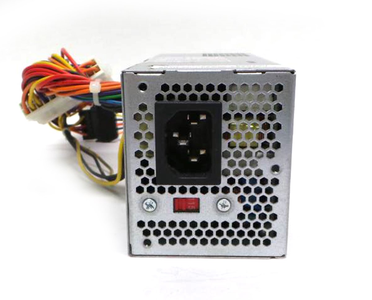

What I recommend is using a low powerered GFX card that won't require a PSU upgrade. A lot of the lower end 10-series NVIDIA cards are super low power draw and you may be able to pull it off. Just be sure to get a slim/low profile model.
Dell tends to run PSUs like this:
https://www.amazon.com/Genuine-Replacement-Dell-Optiplex-Replaces/dp/B00U1P42IK/ref=sr_1_fkmr2_3?ie=UTF8&qid=1489713272&sr=8-3-fkmr2&keywords=dell+sfx+psu
On the case, you can see some what looks like extra room from the edge of the PSU/screw housing to the side of the case, unless its occupied by some Dell Plastic Shroud type crap or hard drive like usual n the SFF cases.

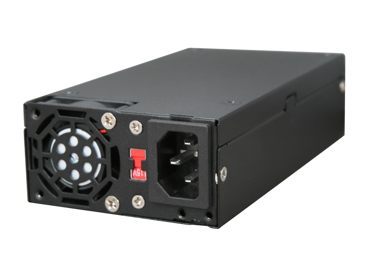

There are some strange alternatives out there that probably won't fit without modding the case:
ie. APEVIA ITX-AP250W but its 250Watts or 300Watts not 500watts. Here.
