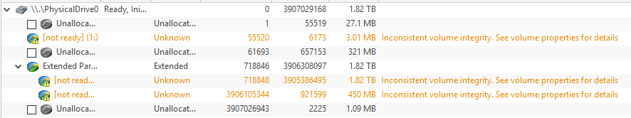

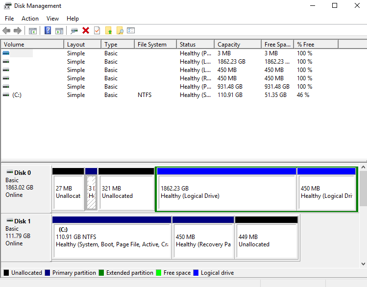

A few days ago a friend of mine deleted my partitions off of my main drive and its been causing me so much hell. I've taken the hard drive out of my computer, put it in another and used the Minitool partition recovery program to restore them and rebuild the master boot record. after doing that, i put my hdd back into my main computer and it still won't boot windows. my friend tells me he'll bring a windows usb to my house to try startup repair. didn't work so he left. at the moment i have the hdd in another pc and my plan is to extract all my files that i need to keep onto an external hdd and fresh install windows on my main hdd (the one that has the partitions deleted). But i've ran into another problem. the hdd is in this computer as I type this but will not let me access any files through windows file explorer. even though the drive shows in device manager and in disk management. any help would be greatly appreciated either to get the hard drive to function normally again or if that fails to extract files and fresh install windows. thanks.

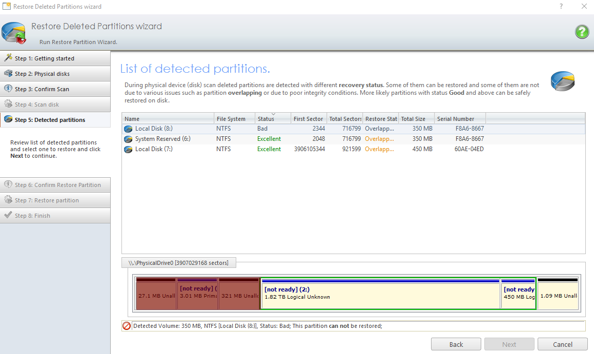

I've downloaded active undelete and started the partition recovery wizard and selected the available sectors to be scanned and this followed:

3 minutes ago, Thread212 said:
Do u see the status? if its bad then it cant be recovered.
and overlapped mean the partition has been overwritten with the new partition (overlapped) u got the point right?
Make sure u remember the capacity of the old partition.If u recover the wrong partition then the old partition u were trying to recover will be overlapped and will make it more harder to recover.
and try to run deep scan so u can see more result.
the other partitions cant be scanned because of "inconsistent volume integrity". what is causing thise6622518b7df22656a1e843fae620fa1.png

Because there's a missing information on the volume. mostly because its a partition from thousand years ago that has been overlapped thousand times.
Just recover the right partition and dont make any mistakes.
it isnt letting me recover any partitions Status; Excellent . This partition can not be restored. Status; Bad. This partition can not be restored

Seriously though, why the fuck would your friend delete your partitions? As some juvenile little joke? Was a fucking asshole. I hope your friend feels really bad.
From the looks of it, the partitions are corrupted. You might be able to recover some random files here and there from it, but you're not restoring Windows.
My suggestion: Backup any files that are still accessible to another drive (A second HDD or a USB flash drive, etc). Then, delete all partitions and reinstall Windows.
