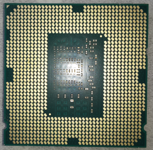

The CPU socket pins look ok. There was a spec of dust on one of them, and there appears to be some thermal compound on the edge (see middle right)....
Are we sure its ok to go at this with  isopropyl alcohol? Makes me kinda nervous just handling the CPU xD
There doesn't appear to be any burns around the 24-pin connector, and yeah I haven't done any overclocking.
https://linustechtips.com/topic/645690-ram-troubles/#findComment-8314365
Isopropyl Alcohol is 100% safe on CPU's. I often bathe mine in Isopropyl or Acetone when delidding. I do see the paste that you are speaking of. I would be careful about over-applying paste, as I do see residual paste in other areas of the CPU, but none of them are making contact anywhere dangerous, at least not from what I can see here. Once you clean it and reapply the paste and cooler, try the ram slots again. Let me know how it turns out.
It's going B| I gave the CPU contacts a good cleaning, used less paste than last time (slightly more than a rice grain), and tried not to over-tighten the cooler which is a Kraken x61. I'm not 100% sure what the issue was, but I suspect that it was the CPU contacts. On first-glance it looks fine, but I did see a couple of flecks of whatever on 1 or 2 of the tiny connectors. I also spotted a tiny bit of thermal paste lying in the CPU socket immediately before I put the CPU back in.
Thank you for your help, much appreciated. :)
https://linustechtips.com/topic/645690-ram-troubles/#findComment-8314787
That is absolutely amazing. Glad I could help! Let me know if you have any issues in the future.
