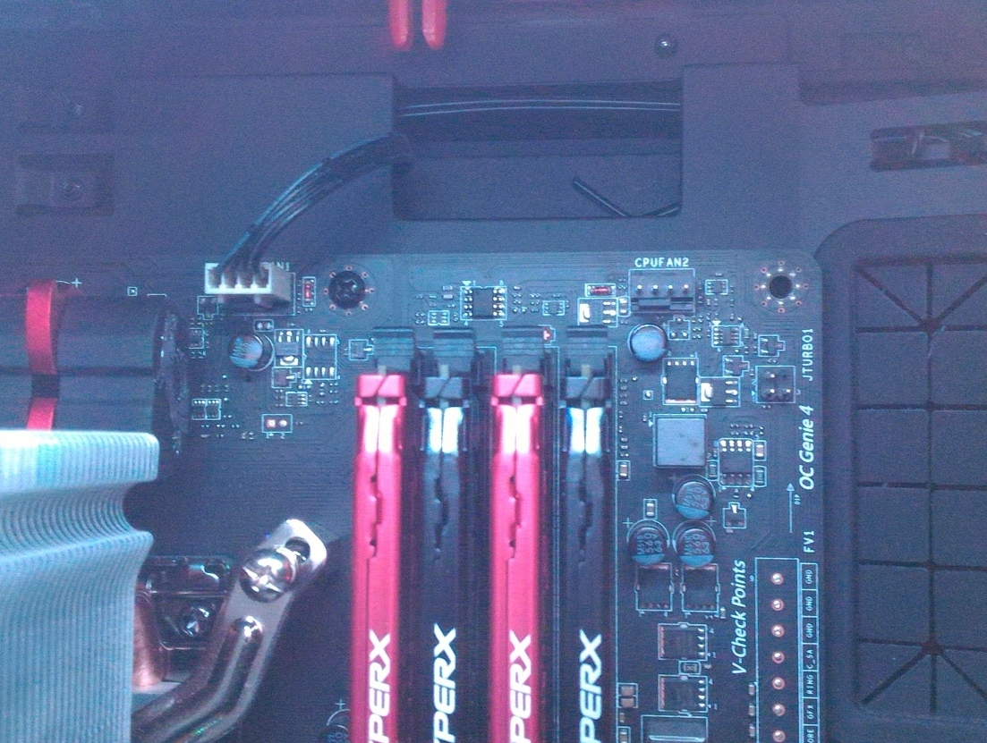

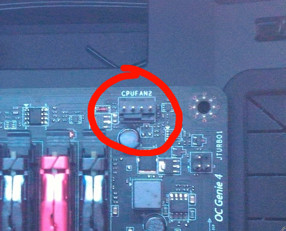

PWM, put that into fan headers on the motherboad, (look at the picture in my post)

3 minutes ago, Aytex said:
PWM, put that into the motherboad header, (look at the picture in my post)
My Kraken X61 is plugged into that slot...
1 minute ago, Aytex said:
You put the 3 pin connector on your X31, into a cpu fan header on your motherboard
Should I swap them around then?
no its fine, your good
just make sure its a cpu fan one because it willl be contorlling your cpu temp's and not your case

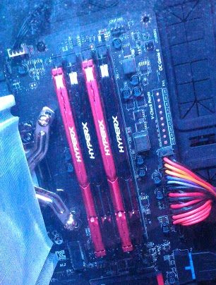

BTW make your ram like mine, so you can run them in dual channel
So one black in slot 1, and 3
or one in 2 and 4
or one in 2 and 4
numberd.jpg?itok=IaPvFx2P
Done that now!
