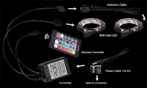

You need to hookup the LED's via the controller since it controls the different colors and modes. It should hookup like this here where the controller has a split with two cables for the LED's, however it sounds like possibly you have a defective unit or something causing one of the lines to operate with a delay making it go out of sync:

Oh I see then it's not uncommon for that to occur since there are tolerances in manufacturing with the controllers or integrated circuits so it can cause them to be slightly out of sync. You might be able to get away with splitters and run all 4 strips off of one controller but to confirm does the unit have any data on it's max amperage or power capabilities.

From looking around it seems like they can provide 6amps on the output so you could use splitters to have all the LED's on a single controller:
