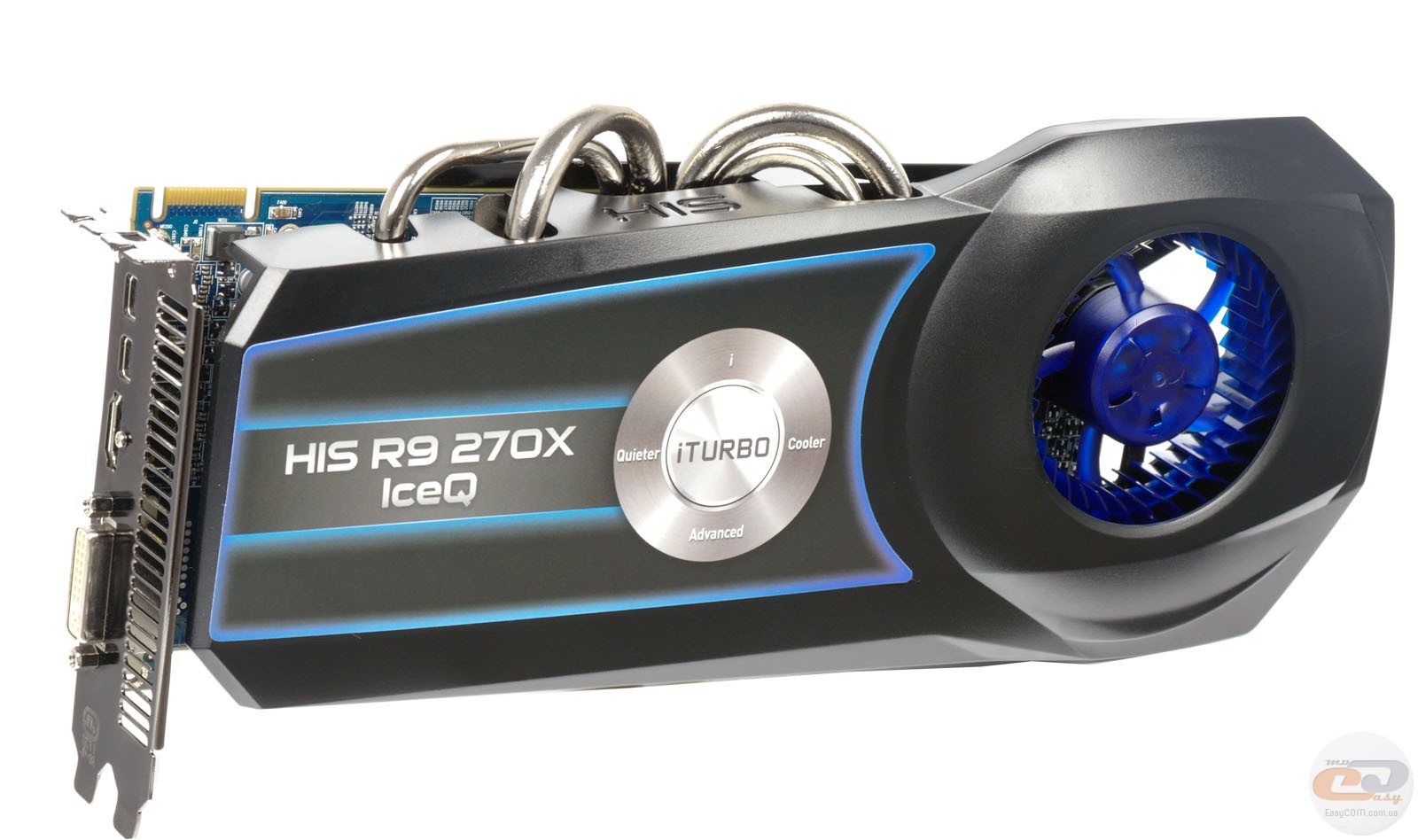

My R9 270x has the GPU die surrounded by a green area with lots of little silver dots on it. When i took off the cooler both these areas had thermal paste on them.
I cleaned this off and only put thermal paste on the die itself and not on the area surrounding it. Is this the correct way to do it or should i have made sure the whole area was covered??
Heres a picture of what I mean. Am i only supposed to put thermal paste on the silver part?

To the shiny part the middle square.

I've tried adding thermal paste to the outer part a long time ago. No temp diff and it just makes a big mess.

Just a small pea sized blob of Thermal Paste in the middle of the silicon is all you need. :)
The little dots around on the green PCB are Capacitors, and do not need any thermal material on them. If you accidentally use electrically conductive thermal paste and smother the whole area with it, you would likely see big problems.

Well sort of, A lot of pastes use metal in the paste to help heat transfer, it's more of a capacitance than conduction, though there is a slim chance a short could occur. Better to be safe then sorry.
The Coollaboratory stuff is definitely conductive though. It's basically liquid metal.

I heard the cross is safer. The dot is handy with a heat spreader but this is a die and if you miss a spot, you're boned.
If you somehow manage to miss a spot on the die, then either you're using too little amount of TIM or your heatsink isn't flat. :P
That being said though, on the bigger GPU's I use the cross method with very small blobs in each "section", I just recently did this with my GTX 780, and that has a whoppingly huge die.

Those temps are fine, no need to mess around with it any further. :)
